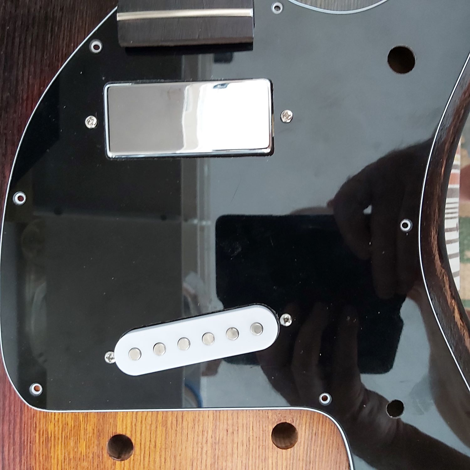

Started a new kit this week, a Mosrite copy. Thought I'd try my hand at a sunburst. Using Feast & Watson Prooftint and doing it by hand. Started by using sanding sealer on the body then a 320 sanding. Gave the back of the body a go just to see how good/bad it might be. Back looked reasonable after a first stain so thought I'd try out the front today. As you can see from the photo, it's not looking too good albeit first cover. There are patches where it seems the wood (Ash) is simply not taking up the stain near the bottom. I've had this once before on my 335 but dismissed it as a fault in the wood. Any ideas how to retrieve the situation before I head for the sandpaper?![]()
Reply With Quote
It must be glue (!) on there to leave those marks. I have never had much success staining on sanding sealer with FW products (I know others have which is why I tried, and tried again! on test bits of wood). Maybe don't go above 180 g sand paper before adding the stain (which is what some people on this forum recommend).
