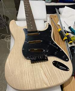

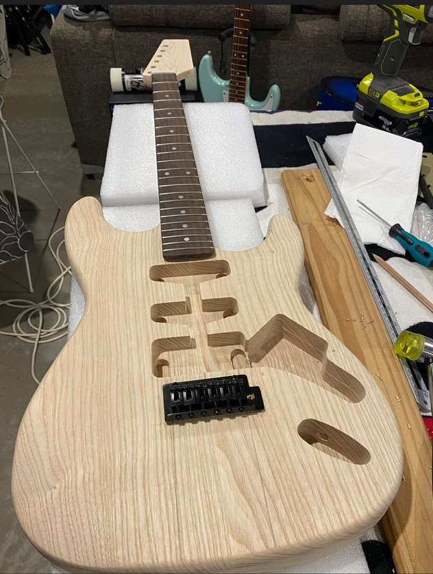

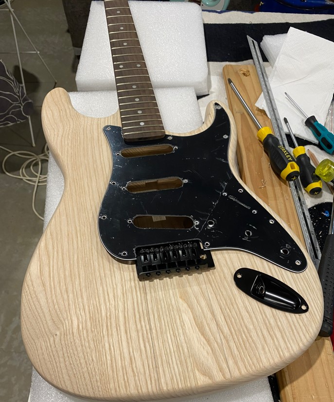

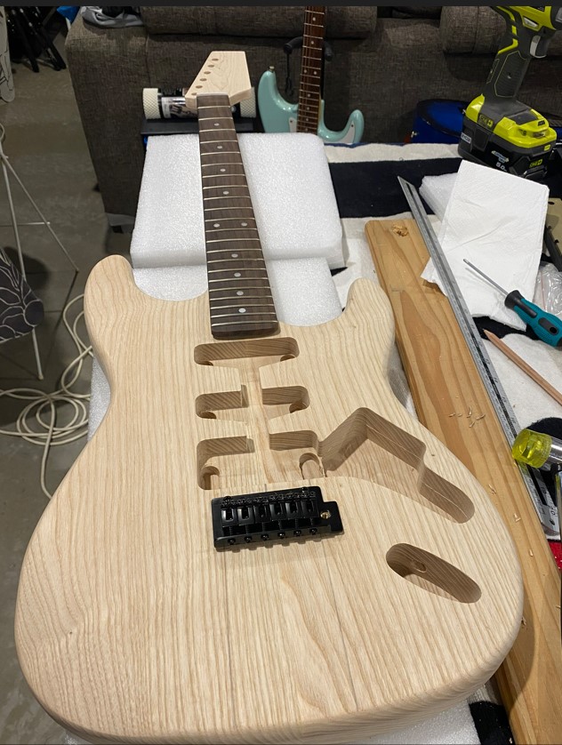

    Strat
    Have black hardware from PB. Added a brass block to the bridge from musiclilly. I have tonerider vintage pups. I am still trying to decide if I just use a black dye and sand back light and wipe on poly or if I want to grain fill first in black, sand back and then do the dye for a smooth surface. I think I will try the dye only first and see what comes out as I can easily just grain fill then.
    Was going to use some Gotoh pots but they did not fit so I have used some alpha minies.
    I have found that the machine heads feel cheap and are not solid. Will see how they go but suspect they will need to be replaced (also on he tele - they have rubber on the tuner knobs???). The chrome heads from PB that I used on my last build were much higher quality.

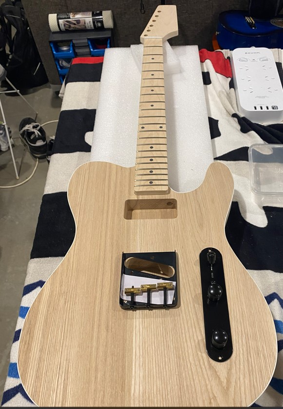

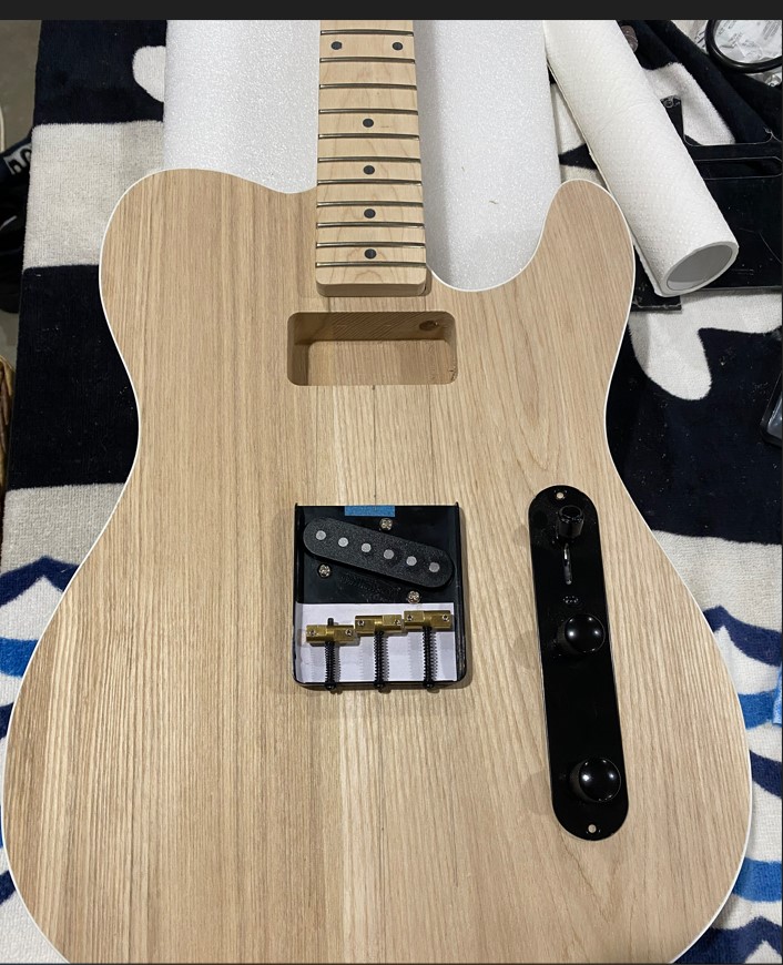

    Tele
    I got this kit with the black hardware as I had a black wilkinson bridge already and some tele pups I could use. As it came with binding on the front I have had to rethink the whole project - no more arm cut. I like the look of the wood grain and the pick guard provided is really rough so I have decided to leave it off. I have just ordered a pup frame and a wilkinson vintage neck humbucker. It will need a bit of modification to the neck pocket to fit the frame but it will leave the rest of the body clear.
    Have done a bit of work the the bridge pup routing. Making it bigger to fit the pup and making space for the wires to exit as the hole was not low enough to go under the pup. The control channel is narrow but next job is to widen it to fit gotoh pots that would not fit the strat build.

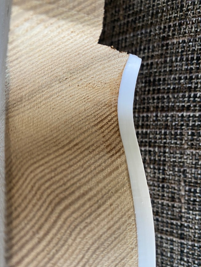

    Question 1 ?
    You will see in the pictures that there is glue on the body from the binding. This is in quite a few places. Is there a way to get rid of this or reduce it before adding a dye?

    Don't rely on just looking for glue marks as you can easily miss them. Wet the wood with methylated spirit, turpentine or white spirit (nasty smelly stuff but cheaper than turps) and you'll see the lighter spots where the glue prevents the liquid from soaking into the wood. It's not always 100% effective, but better than just using your eyes on the dry wood.
    Some of that should come off with sanding. Some of that binding is quite proud of the body so you'll probably want to level it off anyway.
    Otherwise the normal recommendation is Goof-Off, an acetone based glue remover. Or you can use pure acetone (the extra ingredients in Goof-Off make it a better glue remover but acetone should work). You'll need to work it into the wood, ideally with a small soft brass-bristled brush (Amazon/eBay/auto stores). But mask off the binding first as acetone will first mark and then dissolve the binding if left on too long. But you can always fine sand and polish the binding for any small marks made during cleaning.
    Acetone can be used to stick binding to the wood and you can dissolve binding in acetone to make up a mixture for filling small gaps between binding and the body.

    Thanks for the info as always Simon. I have acetone at home so I will try a bit and see how it goes. I have a citrus based glue remover but I am a little worried that it is a bit oily and that could cause more issues.
