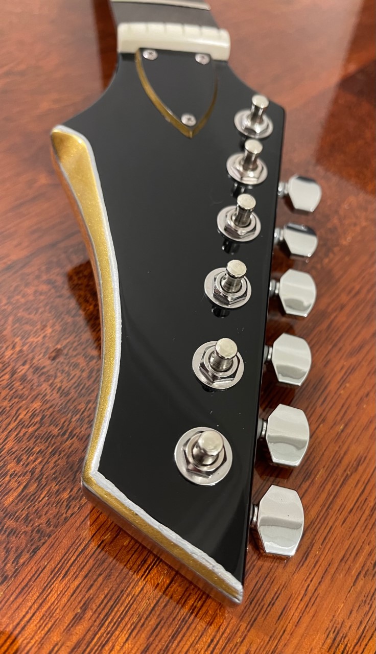

    Tonight I have essentially finished the neck and head stock.
    What I've done is put a scallop on the bottom edge of the head stock, painted the face black and accented the scallop with gold.
    I started off with a filler/ primer, block sand (x2), colour, block sand (x2) clear, block sand (x3) then a cut/polish with Meguiars Scratch X 2.0 then a nice Carnauba wax. similar thing with the truss rod cover. I accented the edges gold and kept the top black

    Nice. I like the headstock design with the black & gold.

    Hi and welcome Animal.
    The headstock is looking great.
