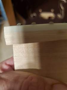

    S$/t!!! Going to try to tap it down with a mallet, but it's awful high. Click image for larger version.

    Maybe best to just file it down and then reprofile and polish it, I doubt it will get a lot of use up there and it doesn't matter if the last fret is slightly lower than the rest as there are no other frets for the string to catch on.
