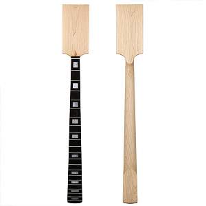

    G'day Ozzie,
    I bought one of these earlier this year for a semi scratch build yet to be started. It has genuine J Bass width at nut but configured with a G Style headstock which is perfect for what I have planned and measures 20 cm along the top edge, just enough room for 4 in line or maybe MM 3 + 1.
    https://www.ebay.com.au/itm/202815446784
    Cheers, Waz
