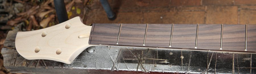

    The neck on the Cort is 22 frets, and I could have sworn the kit back in November was 22 frets. The kit disappeared for a bit from Pit Bull's page, and now it's back as 24 frets , which is what came in my kit. No biggie, I will need to modify some curves to blend in with the neck access of the kit.

    The kit neck had no nut, but it was marked, but not fully sawn:

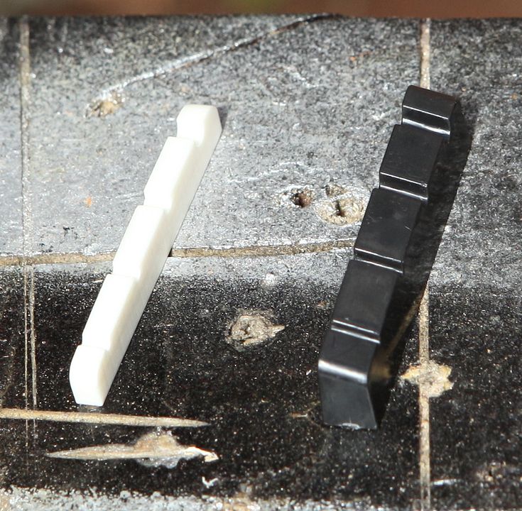

    The last surprise was the nut. I ordered a bone nut, and was expecting a direct replacement for the plastic nut... erm.. spot the difference:
    Kinda disappointed with the bone nut. Screw it! At least one of Gene's axes had a brass nut, so I'm gunna make me one!

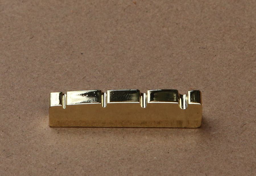

    I went with @Andyxlh 's suggestion and got me s big brass one! :

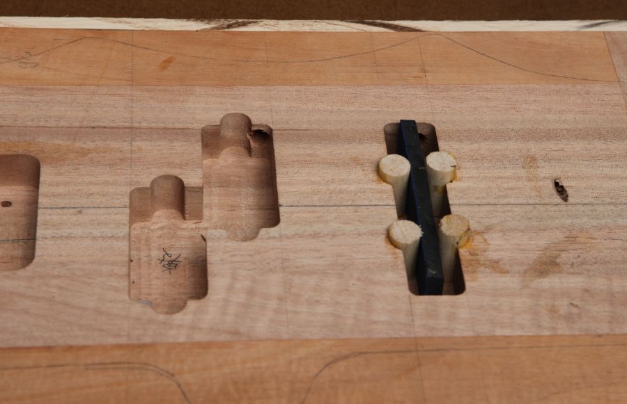

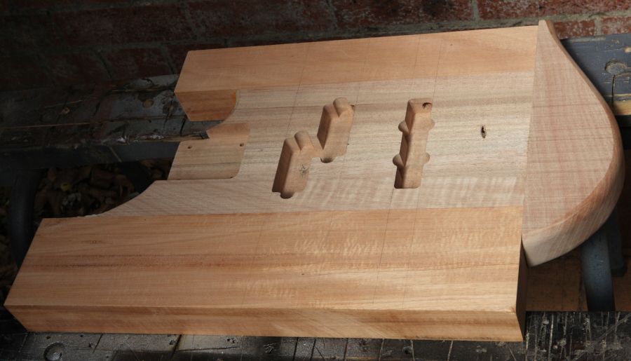

    Some time ago (about 6 months) I hat gathered all the hardware. During my research I discovered that prior to the Cort (which uses Mighty Mite pickups), Gene had an affinity for EMG pickups. Unfortunately *active* EMG pickups. I'm not a fan of actives, so I went with another of EMG's offerings.. Geezer Butler signatures. A thought occurred to me that although the over all size of the pickups may match, the mounting tabs may not. Sure enough, while the PB pups fit just fine, the Jazz pup didn't. To remedy the situation I glued in some dowl, used some foam from a mouse mat as a clamp and:

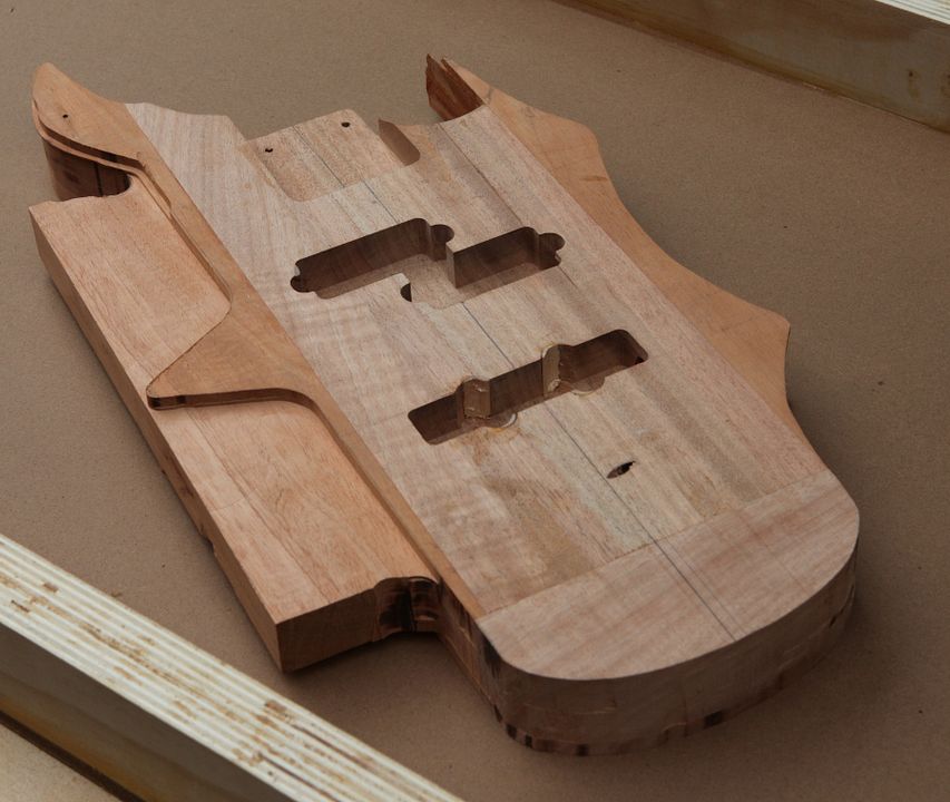

    I used a flush cut saw to cut the tops off and a chisel to cut away the excess, then a 1/2 in forstner bit to cut new mounting positions. I cut the channel for the blade of the axe, but made a beginners mistake and got my calculations wrong, thinking the wall of the channel was on the fence side edge of the blade, so i was out by the kerf. I wanted a channel that was a few mm narrower than the blade , to give me more material for shaping the scoop of the blade behind the bevel. As it turned out the blade blank was a snug fit. The sides of the rabbet are very thin and as a result at some point cracked. I seeped thin CA glue into the crack to stabilise it and to give it a shot of not ripping apart when the body gets routed, I cut some scrap maple to support the sides while it gets routed.
    I have made further progress since this pic was taken, but will post later so this post doesn't get too bloated. Untill next time .....

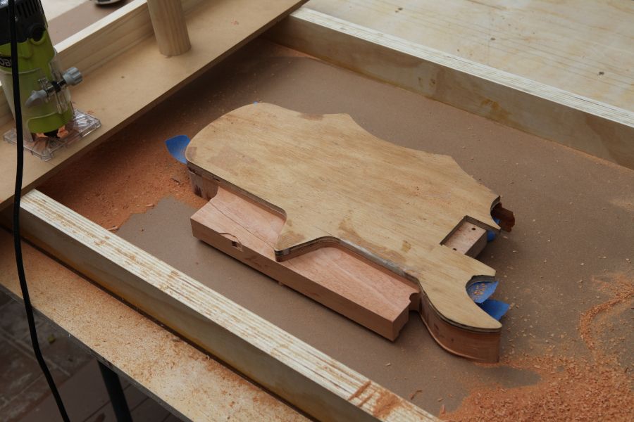

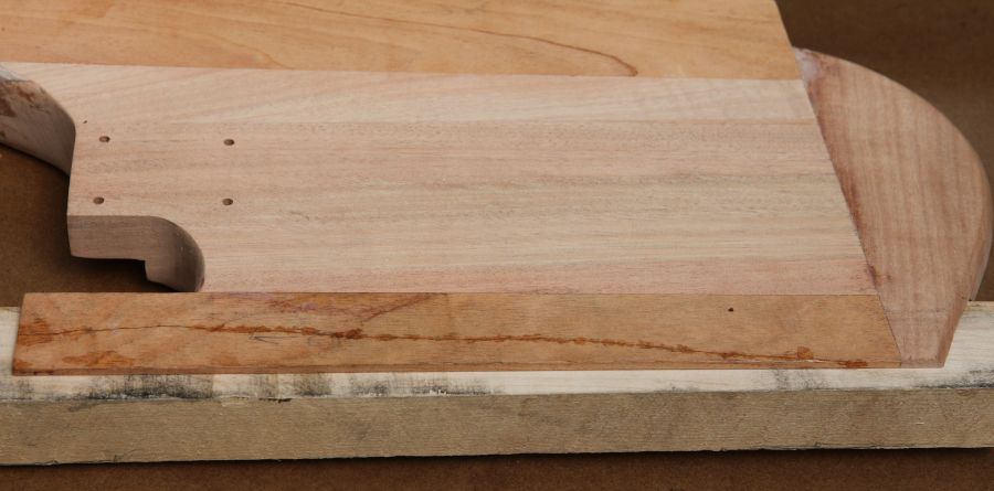

    I made a template to use the router to form the shape of the body without the blade. Things kinds worked and kinda didn't. The double sided tape I used didn't hold and the template moved. I had to clamp it on and move the clamps around. A few times I must have not held the router flat because there were some gouges and a pattern bit just follows those once formed. No great drama as it's getting painted I can fill the mistakes with epoxy. I threw together a planeing jig to clean up the area that will become the back of the blade:

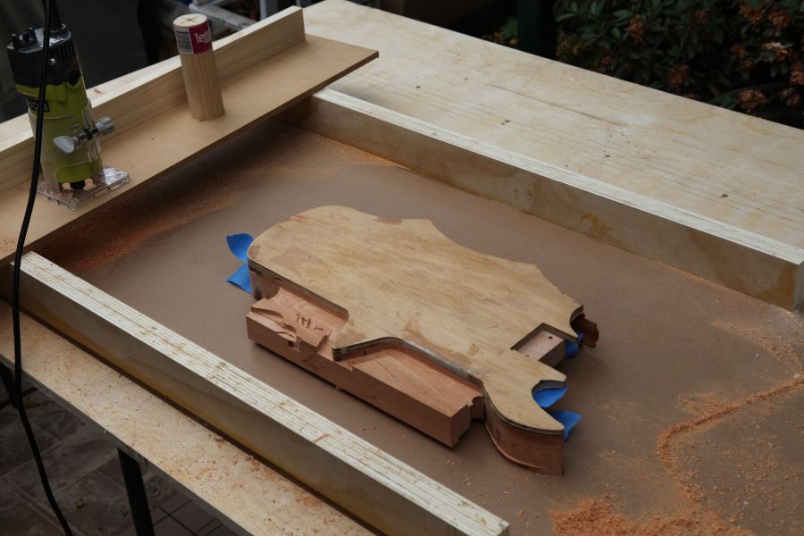

    and this is what it looked like after planing. I used the pattern bit and the template to avoid accidentally taking a chunk out of the body and this time I used the masking tape and CA glue trick instead of double sided tape.It worked well.
    Thanks to the support of the piece I had in the slot for the blade there was no tear out. So far I'm finding the maple and the mahogany to be very workable.
    And this is the progress so far on the blade:
    I still have to route the cover slot for the control cavity, and I drilled the jack hole slightly off centre to better connect with the control cavity. I suspect I didn't need to, so the jack is gunna look a little weird. I used an angle grinder with a 60 grit flap disk to remove bulk timber from the edge. I still have to refine it more with a ROS... probably with 80 or 100 grit. I suspect a belt sander would have been another option to remove the bulk of the edge. Good thing it wasn't paulownia... 5 seconds with 60 grit on the angle grinder and there would be no blade left!
