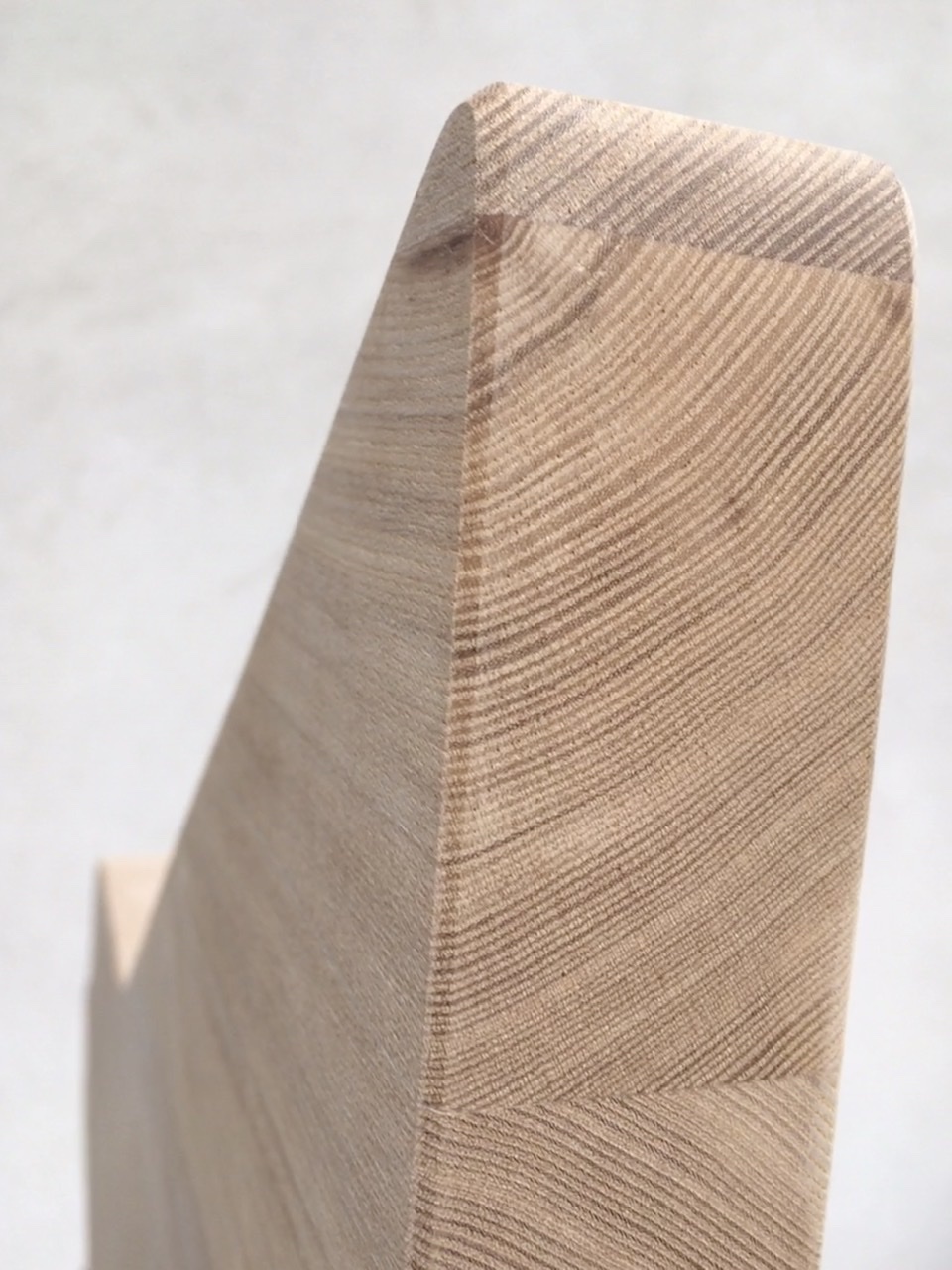

    I realized I didn’t detail the jack output hole at all yet 🤦*♂️ - so I still have to do that, but at least that gives me time to think about the bevel apperance. First I wanted to round it off, but I really liked how the angular shape tuned out and changed my mind to leave it like that. Will see
