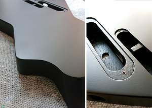

    So finally I am getting into color finishing...
    The surface is really far from being perfect, the mobile pictures can not show it, but there are different structures, so you get a kind of gradient within the mat black...especially front and back of the body (of course), the sides and the neck are great...
    Actually I expeted this when I was done with the grainfiller and sanding the wood...it already appeared there, but I just could not get it out...Some parts of the wood have different hardness, so it behaves different during sanding... I thought the grainfiller would manage this, but it didn't work out as I wanted...
    I have no right place to work, so the whole project I have done mainly on my kitchentable and the coloring in the small cellar, building a kind of paintbox...but it is of course no excuse for the inperfection For what I had in mind for the color of the Explorer was the surface of my Epiphone Les Paul Gothic...well didn't reach it 100%, but it is still a good feeling having done it
    After the first coat of black I sanded into the surface with 2500 grain and 4000 grain to get it more smooth...then made another coat of the black...now it is better
