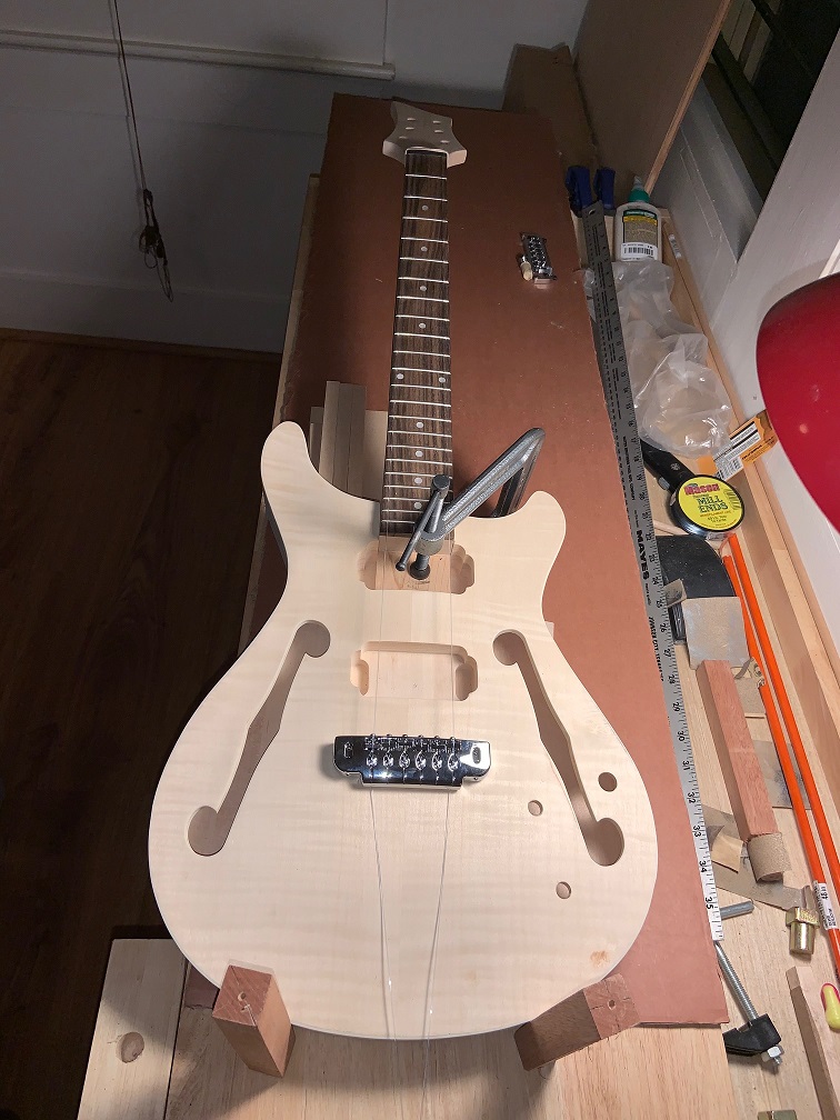

    I went to check the neck/pocket for alignment, and check the scale length. The nut is in the wrong place - I looked up a fret spacing chart and all the frets are properly placed relative to each other for 629mm scale length (for my international friends ) but the first fret to the nut is 312mm, short by about 2.5mm. I'll either have to cut the nut back about half its thickness, or move the nut closer to the tuning pegs and add a spacer. (Note that the bridge is locked in place, and also irrelevant to the spacing issue; I can space the neck 12-3/8" from the bridge, but the nut spacing will be closer to 24-5/8")
    Have any of you had to deal with this before? Any suggestions on what looks the best?

  9. #69
    You should be measuring from the inside of the nut to the high E saddle on the bridge. Measuring to the 12th isn't really helpful, the overall measurement will ensure it's correct.
    So looking for 628.5mm on that measurement. If it's not right you need to move the neck in or out to correct it, it's not a case of jamming the neck into the pocket as far as it will go. The placement is determined by the overall scale length.
  10. #70
    ^^^ this exactly what Sonic said. On my prs kit, I had a sizable gap between the end of the neck and the front of the pickup route. Once I measured it bang on, allowing for some adjustment in the saddles, I made a block the correct size so I could put it back exactly in the same spot. I also ended up gluing the block in with the neck to expand the contact area for enhanced resonance etc.
