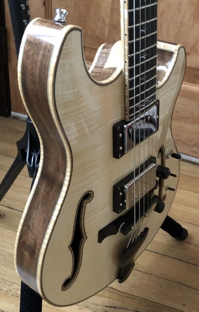

    Today I ordered black Gotoh bridge hardware. Since the guitar is already drilled for Tunomatic I don’t have the option of using a Benedetto style tailpiece. But I think a black bridge and stop bar will give a similar visual effect to the inspiration guitar. The 2 Knobs will be black and the 3 switches will be nickel hardware with black toggles. Black pickup surrounds and nickel pickup covers. I’ll change the nut for a black Graphtech Tusq nut, and the machine heads will either be light weight black, or mini nickel with ebony buttons.
    The inspiration again for reference:
