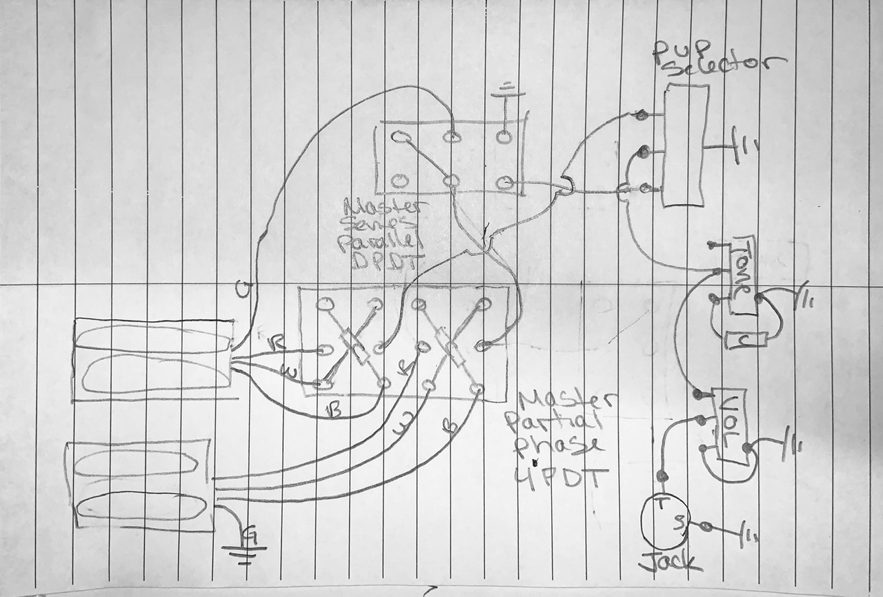

  5. #24
    Apr 2020
    Honolulu, HI
    229
    I”m not a big fan of normal (individual) series/parallel switching low impedance humbuckers, but I do like playing with tone. Entwistle has a diagram for partially phasing individual humbuckers which is supposed to sound better. Also, the Languedoc guitar I’ve been referencing has a ‘master series/parallel switch’ and I found that intriguing. So I came up with a way to implement both. I posted this is a separate thread in the wiring forum (https://www.buildyourownguitar.com.a...ad.php?t=10478) but it’s part of this guitar, so here it is (I might have the pups backwards and IDK if anything else is wrong with it yet.)

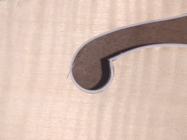

  6. #25
    Apr 2020
    Honolulu, HI
    229
    Another thing I’m trying to figure is how to touch up binding gaps without affecting finish options. If I use CA it might show up if I were to stain the guitar. I ordered some PVC binding to make an acetone slurry though I’m not sure that’s the right approach either. Maybe just heat and straight acetone?

  7. #26
    You could stain and then repair the binding. Though acetone/binding slurry applied with a toothpick could work if you are careful and use a magnifying lens. Alternatively some grain filler should fill the gaps and take up any stain applied.
    Too many options available!

  12. #29
    Apr 2020
    Honolulu, HI
    229
    I totally missed the thought of fixing the bindings after staining . That might be the best approach, then I could use almost any adhesive I choose.
