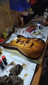

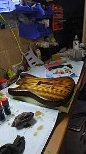

    Had a crack at staining the body today. Used feast Watson stain. Pretty happy with how it ended up i think.
    Looks very interesting. Did you use a dark grain filer, or is that just the FW stain on the wood that's brought out that amount of contrast?
    I used a very slightly darker grain filler, almost the same colour really. The stain is what really bought out the contrasting grain. I used golden teak as a base and worked out to teak brown and then black Japan on the edges. Easy to work with and blend any mistakes.

    Full on sent it with that one mate, stunning result! Well done!

    I think you have blended the burst really well, congrats.

    That stain came out really well, you've gotta be happy with that!

    Haha thanks mate. I was kinda talked out of doing the burst and I thought " F**k it, if its no good, ill just sand it back and try something else." But im pretty happy with how it ended up. I am looking forward to getting the gloss on now!
