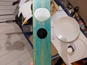

    Waterslide decal paper was from Eckersley's. It was an interesting thing to deal with because the decal goes clear in water, then dries white again (but a different white from what it originally was). But it reacts favourably to Oil finishes (the instructions say spirit or oil based varnishes, but I suspected Tru-Oil would work as a result.
Name:	IMG_20200320_120829 (Custom).jpg
    Also unlike a lot of Waterslide decals I saw online this one: 1) didn't need a clearcoat to seal the ink in, and 2) didn't need to be printed reversed. The paper waterproofed the ink on its own.
    Oh but I should also note: In some of my tests, and on the final decal, it did need a couple of coats of Tru-oil before it went fully transparent.
    Test decal for reference (the white circle was just the backing side of the paper, i got worried that I'd printed on the wrong side initially lol):
Name:	IMG_20200319_053218 (Custom).jpg
