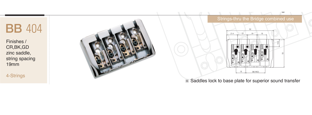

    On my next build, however, given how well I like the Sung Il on my hybrid bass, I am thinking I'll try a Sung Il BB 404:
    These are available for around $20 USD, and have been OEM on a number of basses--including some from Carvin (remember Carvin?) and Yamaha. For 20 beans they seem worth a shot. Of course $20 is about 5x more than a C-clamp, but these are also shiny ;-)

    That Sung Il bridge looks nice, but just check the string spacing is suitable, as 19mm between strings is quite a wide spacing. It got me looking at the 5-string version as a replacement for the one on my '80s Peavey 5-string bass, but that has 16.5mm string spacing (and I thought that was pretty wide!). I can't go any wider on that without the strings falling off the fretboard.

    3,097
    I was actually looking for 19mm spacing, which I think is pretty standard on Fender-style 4 strings. Both my Precision and my Frankenjazz have that spacing. My hybrid with the Sung-Il two point bridge has 18mm spacing, and I don't feel a lot of difference. That said, one of the reasons I don't have a 5 string is that the string spacing always seems too close to me. Fat fingers I guess.
    Carvin guitars are no more, but they had a great rep here. Didn't know they did not market outside the USA. Maybe that's why they went out of business. I do have a Carvin Amp that is my favorite. Great value for the buck.
    Sung-Il seem to make a range of bridges that go from 20mm to 16mm string spacing, although not all have the lock down feature.
    I am also intrigued by the BB007 and BB008
    ...these appear to have a grub screw like the G&L saddle locks and are also about $20 US. There are a bunch of 5 string bridges, but most of the ones I saw on their website that had lock-down saddles were for string-through basses. You might take a look to see if anything appeals. I saw some UK sites that seem to carry them.
