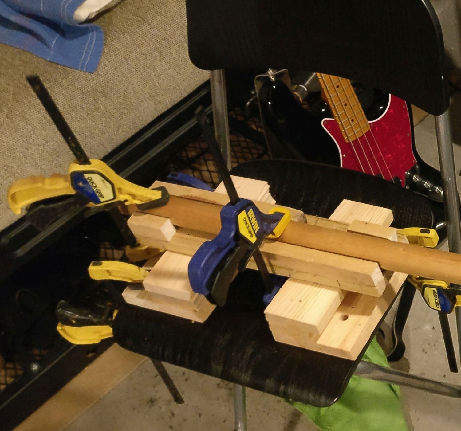

    I recently realized that I was going to need something like this because I am using a brush-on clear coat. Much easier to do if I have both hands free, and if I can turn the body to catch drips and do both sides.
    Unlike my predecessor who built a floor stand. I built this to attach to a tall, stable chair that I have in my garage. You could also make this to attach to a sawhorse or workbench.

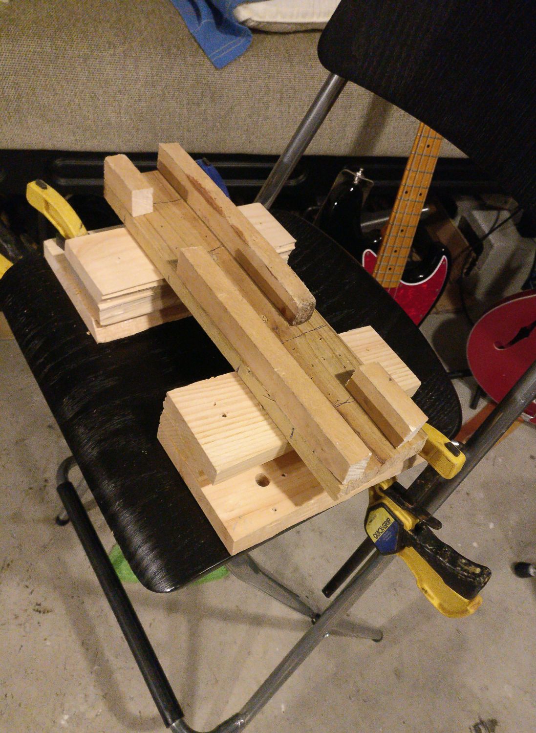

    It's a very simple rack. Here's a pic of it clamped to a chair.
    I attached the guitar body to a meter-long wooden cylinder that was left over from re-modeling a closet. I made the central channel in on the rack.
    [/ATTACH]Click image for larger version.

    To rotate the guitar body, you just need to loosen the two upper clamps that hold the cylinder in the central track of the rack. Works like a charm.
    BTW, if the rack looks rough that's because it is constructed primarily of boards my kids broke in Taekwondo. They have broken so many over the years, I have had to find creative things to do with them...

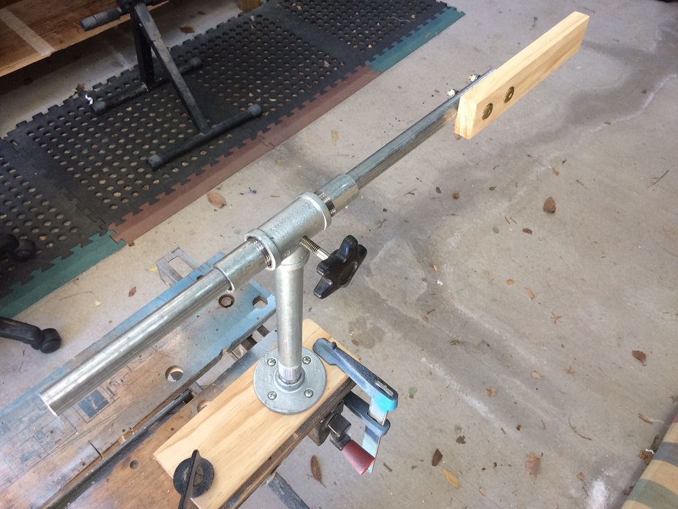

    I made a new rig last year using the same principle.
    I used 3/4" galv pipe with a bit of pine fixed to it for the neck pocket. It works a treat.
    I clamp mine onto my 20 y/o B&D Workmate portable bench.
    I hope that chair is heavy enough to counter the body weight. I'd hate to see a post about a freshly painted body crashing to the ground!
Name:	New Paint Jig 2.jpg
    The chair may look flimsy in the pic, but is actually very stable, and the body is pretty light. If it were heavier I might add cinder block but I don't think it's necessary for this build.
    I made the rack in about an hour out of stuff I had around the house.

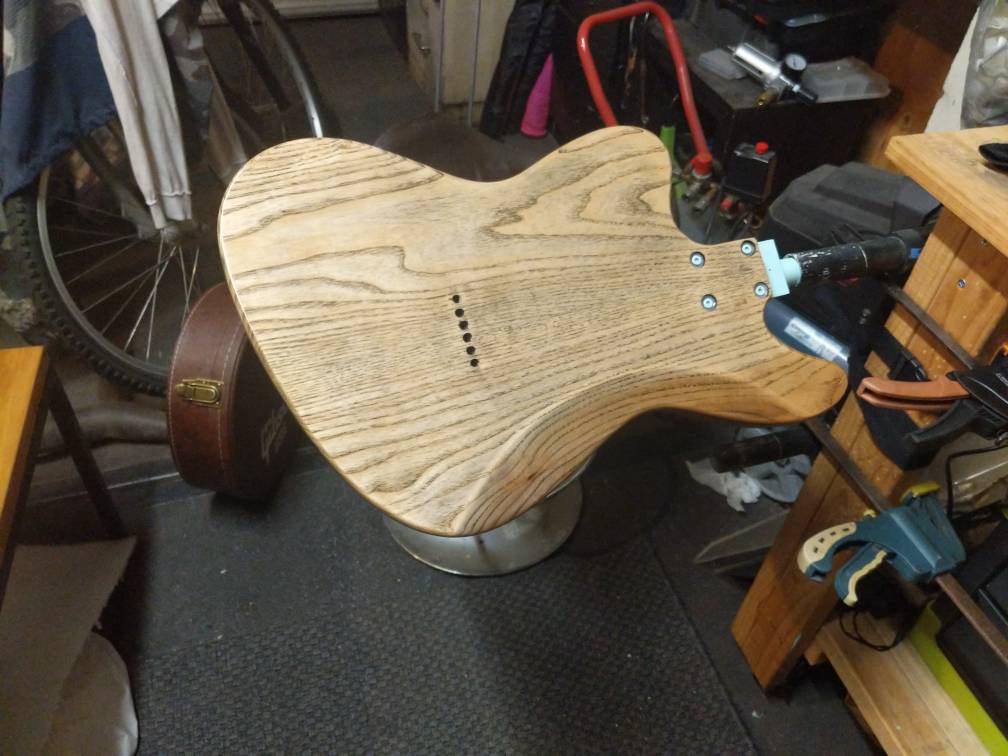

    Very impressive Rotisseries there boys. Beats mine I made out PVC pipes had lying around. It was actually recycled from a first attempt at making wheels for my kayak. Clamped to the side of my workbenchClick image for larger version.

    Yep that was my Ash JTL-1 (July GoTM) in the midst of TruOil progress wanted it on the spit so I could do all sides in one sitting. The rack is a very minty green colour from my Strat build. For that one, I was able to clamp it to the fence post outside for spraying. Super handy.
