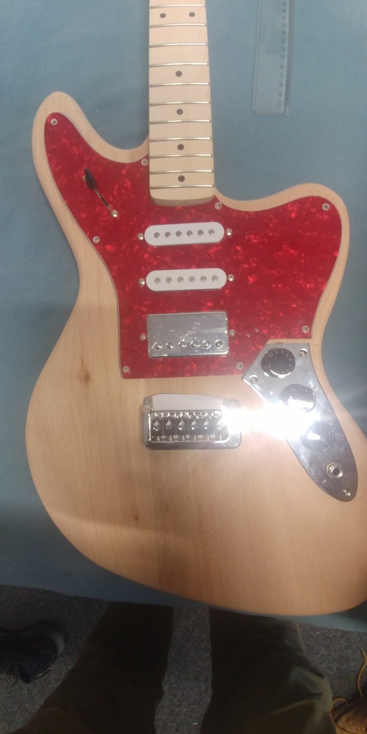

    The first one is a JMA-1 with maple 30" neck
    It is one of the mahogany bodies that popped up in Feb/March.
    Tuners will be Grovers and I will use Twin Loco and 12 Gauge pickups from Warman with a preamp.
    I am thinking about staining the fretboard and switching the pickguard either to a black jazzmaster pickguard (that I'd need to could in order to put the bridge/tremolo in) or painting the pickguard from the kit black.

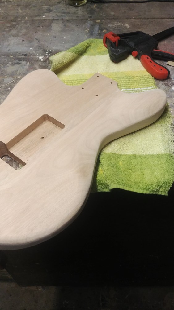

    This weekend I started with the first build.
    I wanted a s slimmer body at the horn and where the belly cut is so I started with some 80 grid sanding and went up to 600 before applying the wood filler and stain.
    The idea was to pop the grain by using black wood filler and sanding it back but the effect is not as strong as I thought. Nonetheless I went on and stained the guitar with a water based mahogany stain that I bought a few month ago. It turned out a little more red and dark than I intended so I had a little fun mixing my stains and added red and a little black.

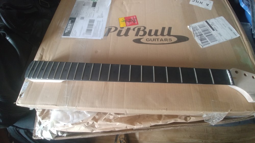

    Other than that I tried a little experiment on the neck. After some of us discussed the necessity of inlays in another thread I liked the idea of black inlays on a black fretboard. So I stained the maple black and I think it works out.

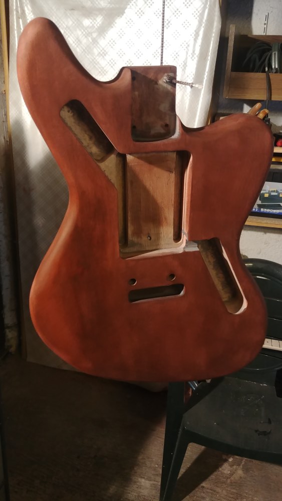

    This weekend I cut the headstocks, rerouted and painted the TL body.
    I was pretty happy with the shape of the JMA headstock (the black one), so I did the same on the other but due a glued on part coming off the TL headstock got a little slimmer.
    I got myself I router and for my first run with it the routing looks pretty good I guess. Actually it doesnt matter because it will be covered anyway but still.
