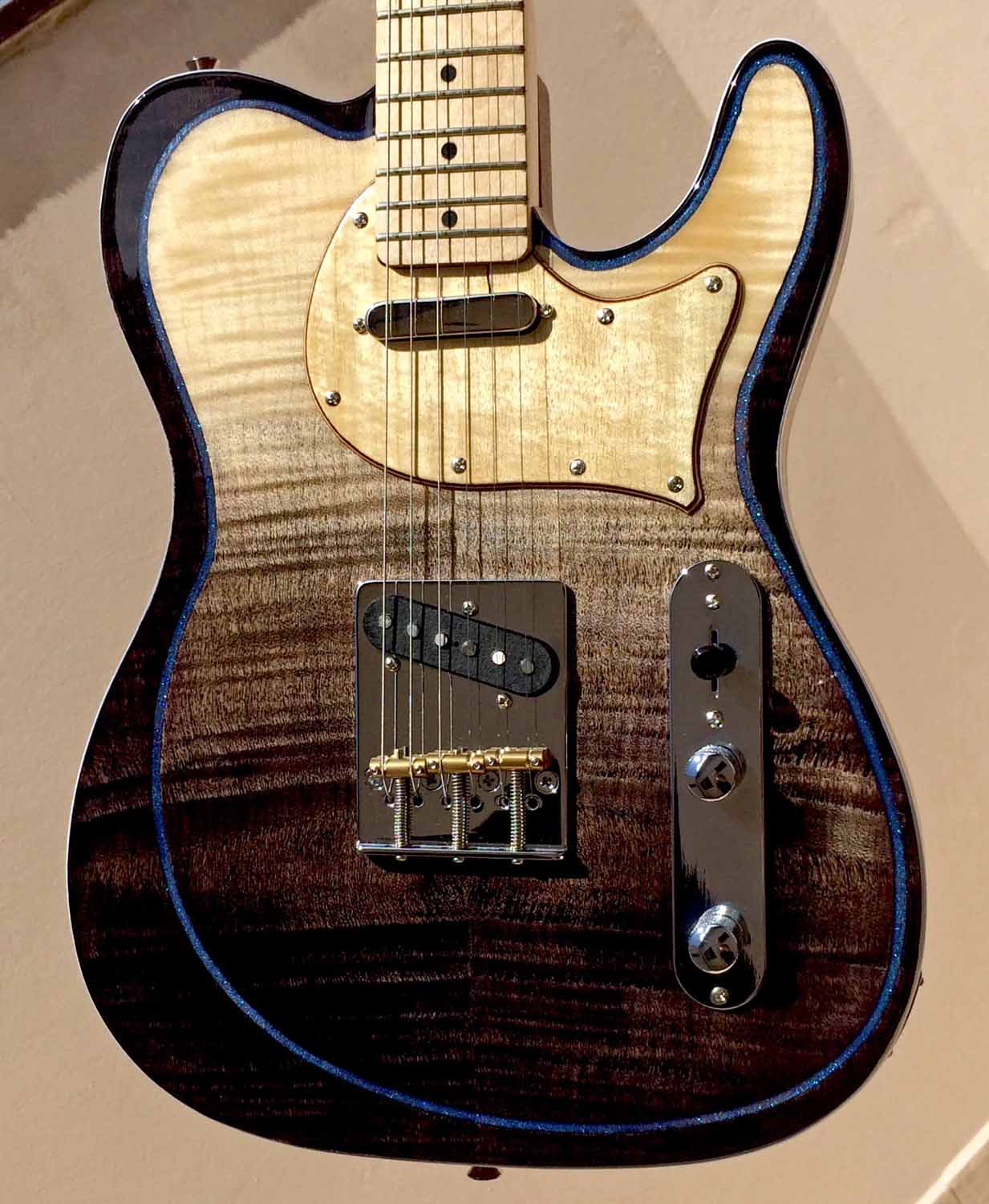

    Backside view, stained with coffee and tru oil. I did not like the bright color of this ash, so I decided to stain with something different and cheap. Forgive me about ferrules, they are little bit misaligned (drilled without table drill bench).
    Really deep and clear finish. My wife chooses those color match (faded black + deep blue purfle). The pickguard was made by hand using 4 layers of 2 species of Australian wood (don't remember wich was).
    Tonerider Vintage Telecaster set sounds good with Gotoh BS TC-2.
