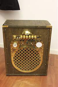

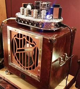

    fantastic job. Now you need to start on the matching amp
