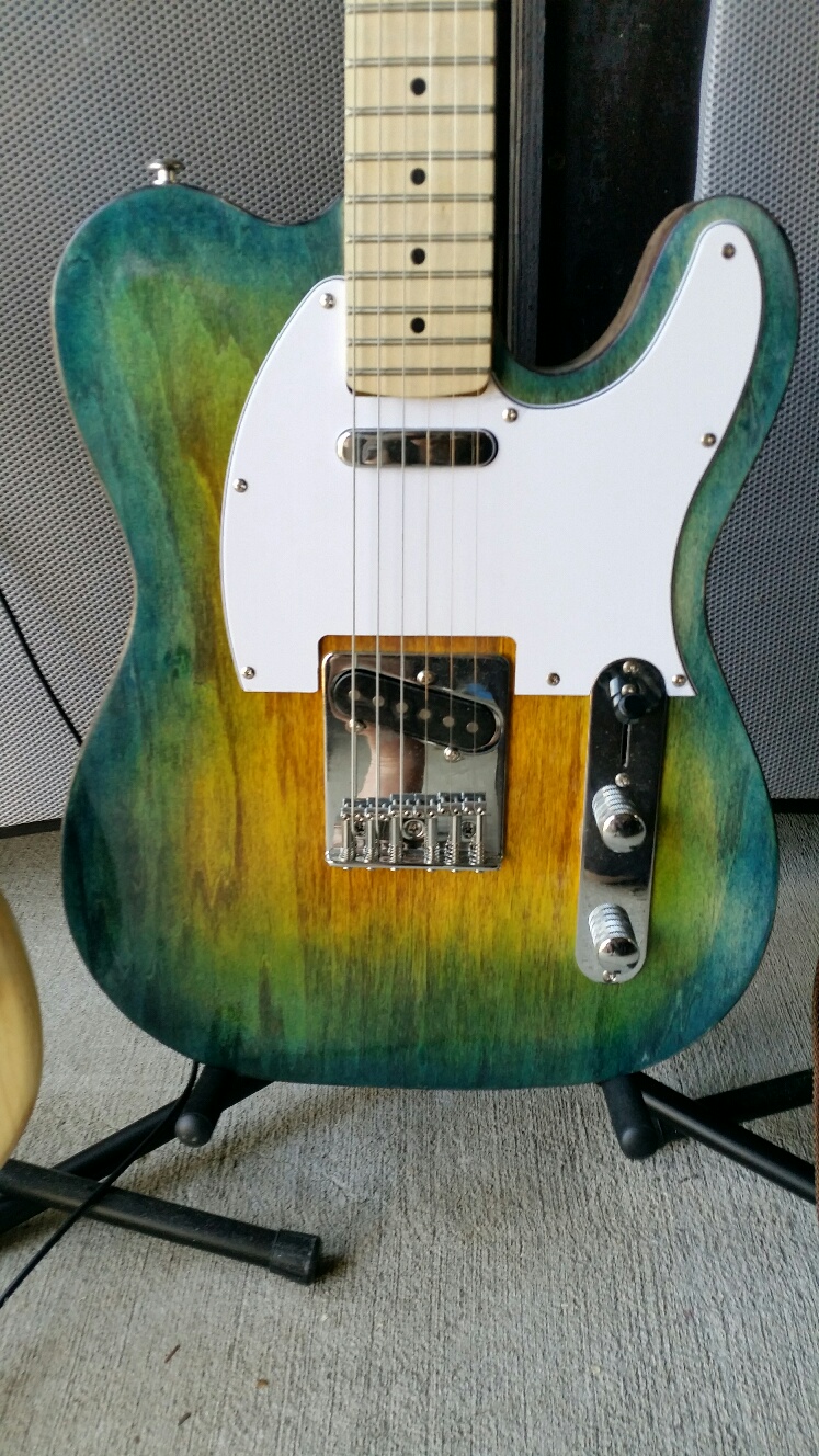

    I did one Tele build some time back where I used Wattle Rosewood stain on Alder and then sanded it back and did a yellow to Blue burst... I call it my Rainbow Tele due to all the colour effects that came through.
    Blue on Rosewood stain turns Purple which is the edge.... Yellow on Rosewood heads toward the Red spectrum near the bridge. And of course Yellow and Blue gives green.... So a Rainbow of sorts is what I got...lol
    It was my first attempt at a burst of any kind so ultimately it still looks a bit crap... Needs more work to finish it off, Any suggestions are most welcome...

    Well in that case hehe. I've taken my Tele back to the drawing board on many an occasion.
    Once there, I'd re-shape that lower bout and correct the ill-fitting pickguard.
    Of course if it was me.....but it aint is it?
    cheers, Mark.

    Yeah... but...but...but it's a cheap fleabay piece of junk.... It's a stretch to even call it a Tele. Does it even deserve the effort??
    So the stains mixed together huh?
    If we waited a couple of weeks before the red stain to cure within the grain, would the new stain not mix with the old?
    Maybe. maybe not.
    I scored an el-cheapo strat copy from the pawnbroker and with a Pitbull neck, turned it into a good playing instrument.
    It was headed for the skip otherwise.
    The experience that I gleaned from that excersise was well worth the effort.
    cheers, Mark.
    (edit) It looks like that 'tele' has a strat shaped neck.
    Surprising what you get when you buy the cheapest kit off Fleabay...
    Actually the neck is closer to a baseball bat handle than any other neck I've ever encountered as I know even real '50's necks aren't as thick/chunky as that one. Nice piece of Alder but the cut is all wrong. For what it is it plays and sounds fine(ish)... As a 2nd ever build it is/was a good kit to practice on...
