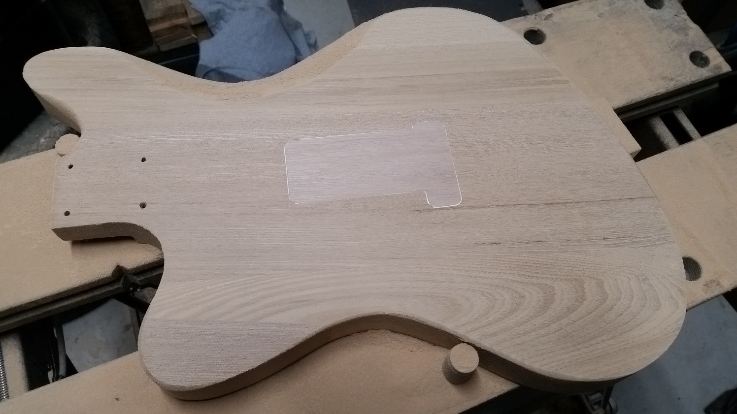

    A bit of trimming on lower curve and upper horn to start with as well as re-sanding/shaping some of the edge curves. Still tinkering with that bit.

    Then got stuck into the back with 60 grit followed by 120 grit to make sure the patch is level with the rest of the body. What has become obvious is that there is no way I'll get away with using a stain for the colour so onto plan B, spray solid colour. Can picture the dark green I want in my head, will be interesting if can get that across to the guys at the local paint place.

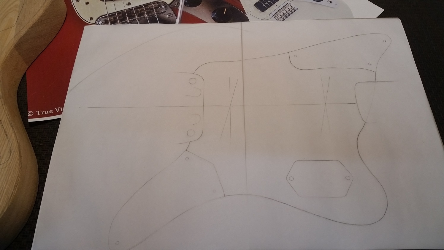

    And have started drawing up the shape for the pickguard. By the time the shaping of the edges has been finished and the corners rounded over, get the feeling will need to move the lower control plate in towards the bridge or the pickguard will be right up to the edge of the body.

    Also dug out the timbermate from around the patch on the back (got paranoid about it sinking back under the paint) and refilled with 'builders bog', seems to be the same as auto body filler.
