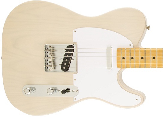

    I'm looking to go for a classic 50's Telecaster finish in a classic white blonde (more white than yellow) similar to the picture attached. So my first question is can anyone point me in the right direction as to achieving this finish? I want the colour, gloss, still transparent so I can see the grain but smooth at the same time(no texture - do I grain fill for this?).

    As I'm sure you know, ash has a huge grain depth, so you will need to fill the grain somehow. I have used feast Watson sanding sealer, but you will need a lot of coats to be able to sand it to a complete flat finish.
    Translucent white? Sorry no idea, but let me know when you find out 😋
    Welcome Ben! If you are going for a translucent white, you’ll need to fill and sand smooth, then maybe use a tinted lacquer to get the see through white you’re after.
    https://www.guitaraust.com.au/finish...s-aerosol.html
    The blonde white might be what you are looking for. Never used this stuff myself, so I hesitate to recommend, but I have bought from the site multiple times with no issues.

    Awesome, thanks for the tips guys! Fretworn looks like a great page, I'm digging the White blonde (cc038) and the butterscotch(cc039), but being lacquer it's likely to yellow more with age from what I can read, so the white blonde is probably the go. I could see the green emerald looking pretty good too with a mint green scratch....oh god! I'll save that for the next one.
