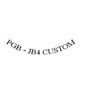

    Can anyone help with logo bending, ive tried a few programs but cant win.
    im looking to bend to logo a bitt to the shape of the std j bass head stock

  5. #65
    Like this?
Name:	Blu Heeler1.jpg
    Oops can't spell
    cheers, Mark.

  8. #68
    I used Photoshop. It's in the toolbar menu (a capital T over an arc).
Name:	PGB Custom.jpg
    cheers, Mark.

    That part is looking good, thanks again KC .still hopin to get the Blu-Heeler logo to bend up/ then down and follow headstock.
    tried word, powerpoint and demo version of illustator. havnt used photoshop b4
  10. #70
    G'day Guv. I was looking into putting text along a line using Illustrator.
    http://www.designeasy.co/2012/05/cre...n-path-in.html
    Had some minor success with it but my brain is telling me it's time for bed.
    cheers, Mark.
