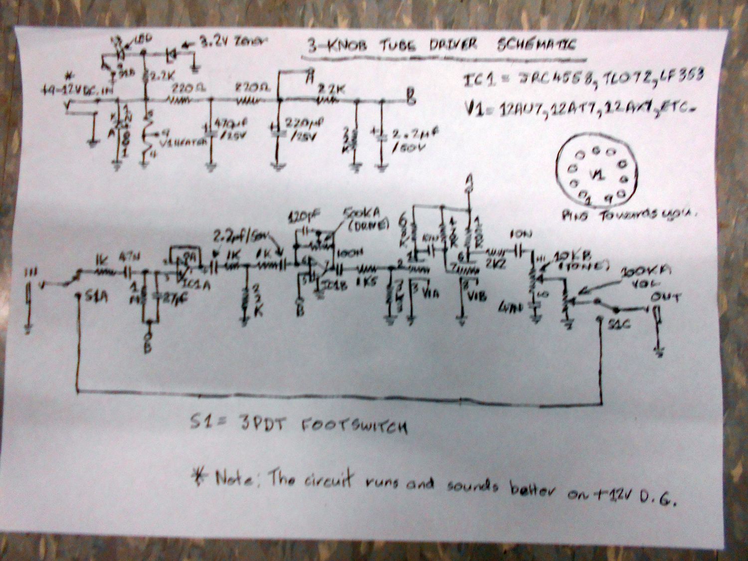

    Here's a hand-drawn circuit-diagram that I'm going to be working from while designing a suitable layout of parts on the 8-way Tagboards:
Name:	Three Knob TD Schematic_resized.jpg
    Looks a lot like a Valvecaster circuit with a 4558 drive... maybe as an alternative you could look at the dual tube designs in the linked pdf... also has lots of interesting info to add
    https://cdn.instructables.com/ORIG/F...6HIK1FLK5B.pdf
    Cheers for that Marcel, I downloaded a copy of that pdf, I've experimented with the Valvecaster circuit in the past but wasn't able to get it working at it's best, maybe the valves I was using were getting a bit worn out, the circuit tended to be a bit hummy, I'm thinking of building a circuit that uses two 12AX7 valves, but with a higher HT supply that's produced by a square-wave oscillator made from a CD4049 IC that drives a Voltage Multiplier circuit consisting of some 1N4007 (or similar) diodes and some 1uF/100V, or 2u2/100V (can even be some 47uF/100V caps too) electrolytic caps, I found that using the circuit I can easily generate up to something like +90V from a 15V DC supply.
