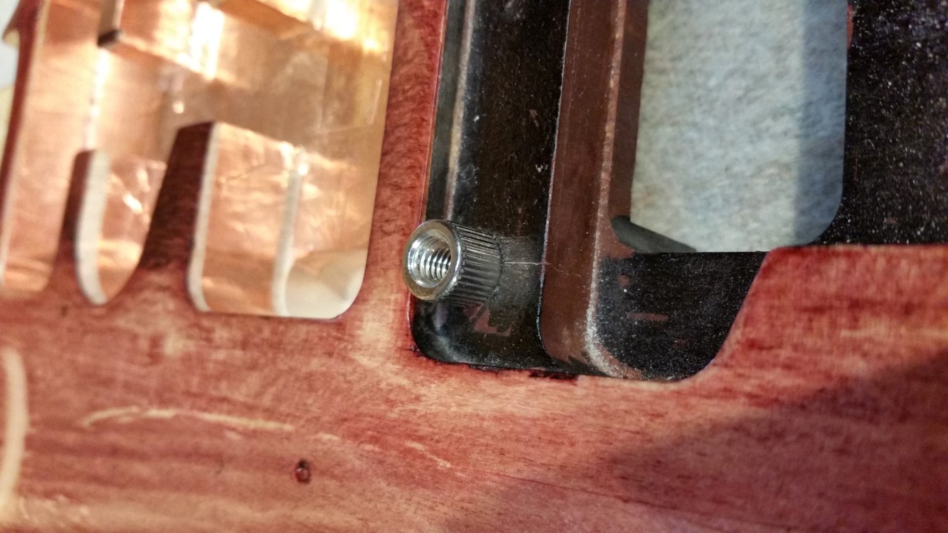

    Exactly how tight should the bridge posts be in the body for a Floyd Rose bridge? I'm up to the stage of putting the bridge on and following what Adam did on the video, I go to tap the posts home in the holes and I'm sure they are too tight. In fact I can see a crack starting from one (see photo) so I'm a little reluctant to just drive them home. I'd rather pull them out and ream the hole out a little, but to what? And more to the point, how do I get it out now?Thanks in advance. Warren

    I had the same experience - I only widened them enough to to remove the paint that had sprayed in them, and they split the wood both vertically and horizontally when I hammered them in.
    Could you screw the bolt in to give you a bit more length, and see if you can wobble it back and forwards a bit to loosen it and get it out? Of course you'd want to be careful to not make the cracking worse, and to not bend the bolt.
    What I ended up doing was hammering them all the way in, then using some thin super glue to wick into the cracks. I had one crack like the one you are seeing form, and another appeared under the other pin, running horizontally to the bridge earth wire hole.
  3. Liked by: gamahucher
    Well, I ended up getting them out just using a hammer with the claw covered with cloth against the body with some ply protecting the finish. To me, if it's cracking, it's overstressed and the wrong size. As it is, because it has cracked, I'll probably have to use some CA glue to limit the damage. Therefore I think I'd be better reaming it out a bit and maybe using some epoxy when the insert is re-inserted or replacing them with other inserts - as long as the internal thread is the right size for the bridge post.
    just a bit further, the insert post has a diameter of 10.3mm and the predrilled holes in the body are 9.2mm. That means over a millimetre difference which sounds like a huge amount. My son used to work in an engineering shop and he tells me the outside diameter of 10.3 suggests a hole diameter of 10mm. Thoughts anyone?
    Well, for what it's worth (surely someone else has a similar problem) trying to fit a 10.3mm post into a 9.2mm hole will cause damage anytime. I had a quick chat to an engineer and he suggested the ideal size into wood would be the diameter to the bottom of the flukes on the insert post. That way the post is held by the flukes and you're not trying to compress the surrounding wood excessively - which leads to cracking. It was really difficult to measure the diameter to the due to the calipers not having a fine enough edge to fit in between so in the end we decided on a very sharp 10.0mm drill turned by hand in a drill press to keep it vertical. This worked a treat and the posts then tapped in just like Adam did in the video. Hope that helps people.

    From a visual inspection, the bottom of the posts are often a slightly smaller diameter than the basic inner diameter of knurled section, which leads me to think that the holes are probably based on the thinner part.
    I'd always try and use a press or a clamp to slowly push the inserts in rather than tap them with a hammer - even a soft faced one - as the extra over-pressure caused by the hammer blow can increase the tendency for the wood to crack. I'm not saying an over-sized insert wouldn't crack even if slowly pressed in, but even if the holes were a better size, too severe a blow might still cause some cracking, as there's not a lot of wood around the back end of the hole.
