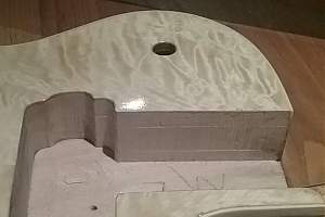

ID:	21064Click image for larger version.
    Did some dt wax on the fret board tonight and it has come up sweet, plus a thinned out coat of oil, i think i will only need a lambswool pad to buff its that shiny and smooth, another 2 or 3 coats and it will look like glass.
    The photos dont really show the quilted maple, as you walk around it the pattern changes to watch it become more pronounced after each coat ita hard to describe
    Bud, that quilt is looking like ruffled silk under that TO. Really nice work Barnsey, looks sweet!

    Thanks andrew, its almost there, ive done 5 coats first day rubbing back each time then 5 coats last week and a sand 4 coats over the weekend and sanded and now a thin coat, i think 2 more will be heaps
