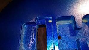

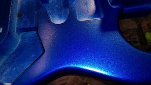

    After a 2nd coat, I noticed a few imperfections. Back to sanding tomorrow.
    Any recommendations on a Gloss Finish?
    I was looking at this one from Dulux
    Nice colour mate.
    Never done a solid spray so no first hand experience comments from me however it looks like a few more primer-sanding-primer stages may have been required before rushing in to do 1st coat of colour.
    Cheers, Waz

    Nice colour mate.
    Cheers, Waz
    I'd guess it would depend on the surface before the primer and the results after it.

    Quote Originally Posted by Hbg View Post
    H,the colour is looking amazing. the process is 2 or 3 primers, lotsa rubbing, 2nd coat, recheck for imperfections, lotsa rubbing, another primer, lots rubbing down, 2nd coat again, then if ok build up coats, light sanding between. When an all over uniform coat has been achieved, at least 4 or 5 top coats of clear, then final buffing. Yes that 2k dulux gloss is the go, JUST TEST IT ON A SAMPLE FIRST...
