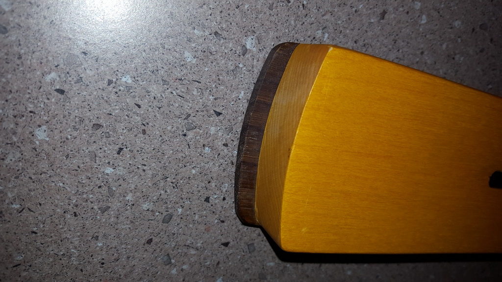

    Too wide at the heel:
    Body neck pocket width: 62.5 mm
    Neck heel width: 64.5
    I measured my Jazz Bass Deluxe neck heel and it's 63.2 mm.
    Not sure if a genuine P-bass neck is meant to be wider at the heel than a J-bass neck (they are different widths at the nut), so it looks to be that both the body and neck are not correct widths (both are billed as replacements for genuine Fenders). The body is probably closer to proper Fender width.
    So I have two options - 1. widen the neck pocket on the body, or 2. make the neck heel narrower.
    I'm not really sure which one would be the best thing to do. Not necessarily looking for the easiest thing to do. Which would be best, in your opinion?
    Probably easiest to widen the neck pocket on the body, but run the risk of damaging the paintwork. Working on the neck is going to be difficult, as the fretboard will have to remain the same width, so it would mean shaving/scraping/sanding a millimetre or so from each side below the fretboard.
    Either way, it will take some work.

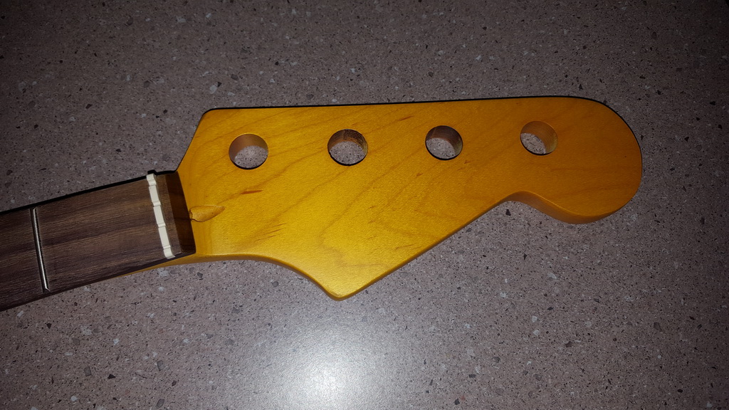

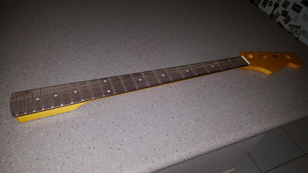

    Here are some shots of the neck. Not bad for 80 bucks (free postage, took about 10 days to get here). Nice satin finish in vintage yellow. Headstock shape is not quite your usual Fender shape, more like an early Strat than P-bass, but close enough.
