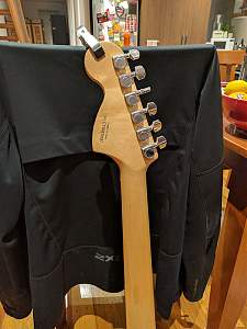

Name:	2017-03-27 19.41.10.jpg
    like the look of the headstock, ready for intensifier.
    will need to paint the truss rod opening black at some point. I have a black Posca which might do the trick.
    some of the final coat was a bit lumpy (Mk II) for the most part it looks fine:
Name:	2017-03-27 19.42.36.jpg
    but there is a spot that's a bit patchy on the back but I'm no sure if thats just the drying process (it's been around 24hrs)
Name:	2017-03-27 19.41.58.jpg

    Looks familiar and have experienced that myself several times on a couple of earlier builds. You may need to do a gentle wet sand with 1200 to 1500 to smooth things out once that layer has had plenty of time to cure and then try and put down another super thin coat or two before going for a final polish.
    Too many coats at this stage seems to end up looking like that last shot.
