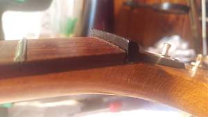

    The new graphite nut seems very high, at least compared to the strat so i will have to resize it i think.
    Edit..... Does anyone know offhand how high from the fretboard the nut is supposed to be?
    I've just measure my very recently purchased MIJ Tokai SG., which is the best setup I've ever had on a new guitar, and I won't be changing it.
    The first fret height is .88mm
    Height of nut at
    Low E 2.35mm
    A - 2.25mm
    D -2.03m
    G - 1.85
    B - 1.77mm
    High E - 1.55mm
    All the above measurements are from fretboard to the top of the nut, they don't include the nut slot depths

    Thanks tweaky, that will prove very helpful.
