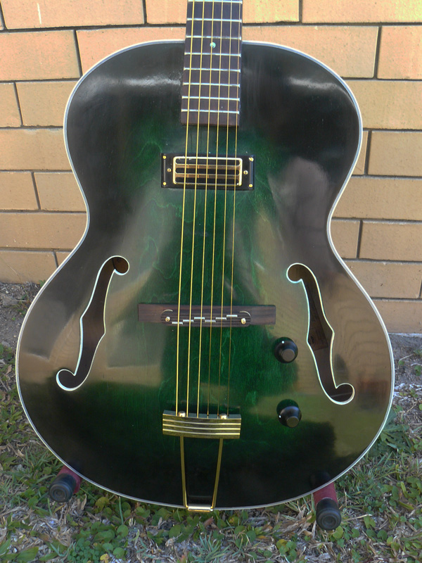

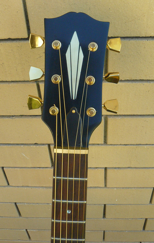

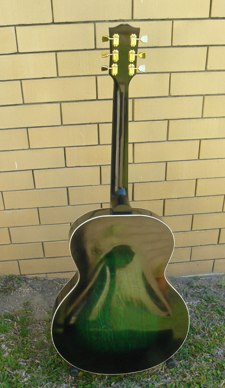

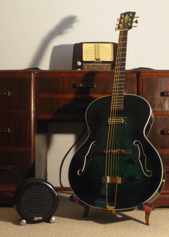

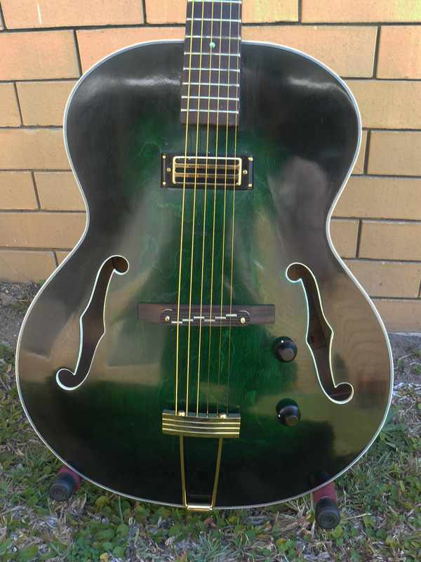

    Finish is green fountain pen ink and auto acylic. Mods : Kluson tuners and tail piece, brass nut, brass headstock inlay,abalone fret markers, mini humbucker, ebony knobs, volume knob is push pull to split the pick up, gold strings,jack socket and strap button.

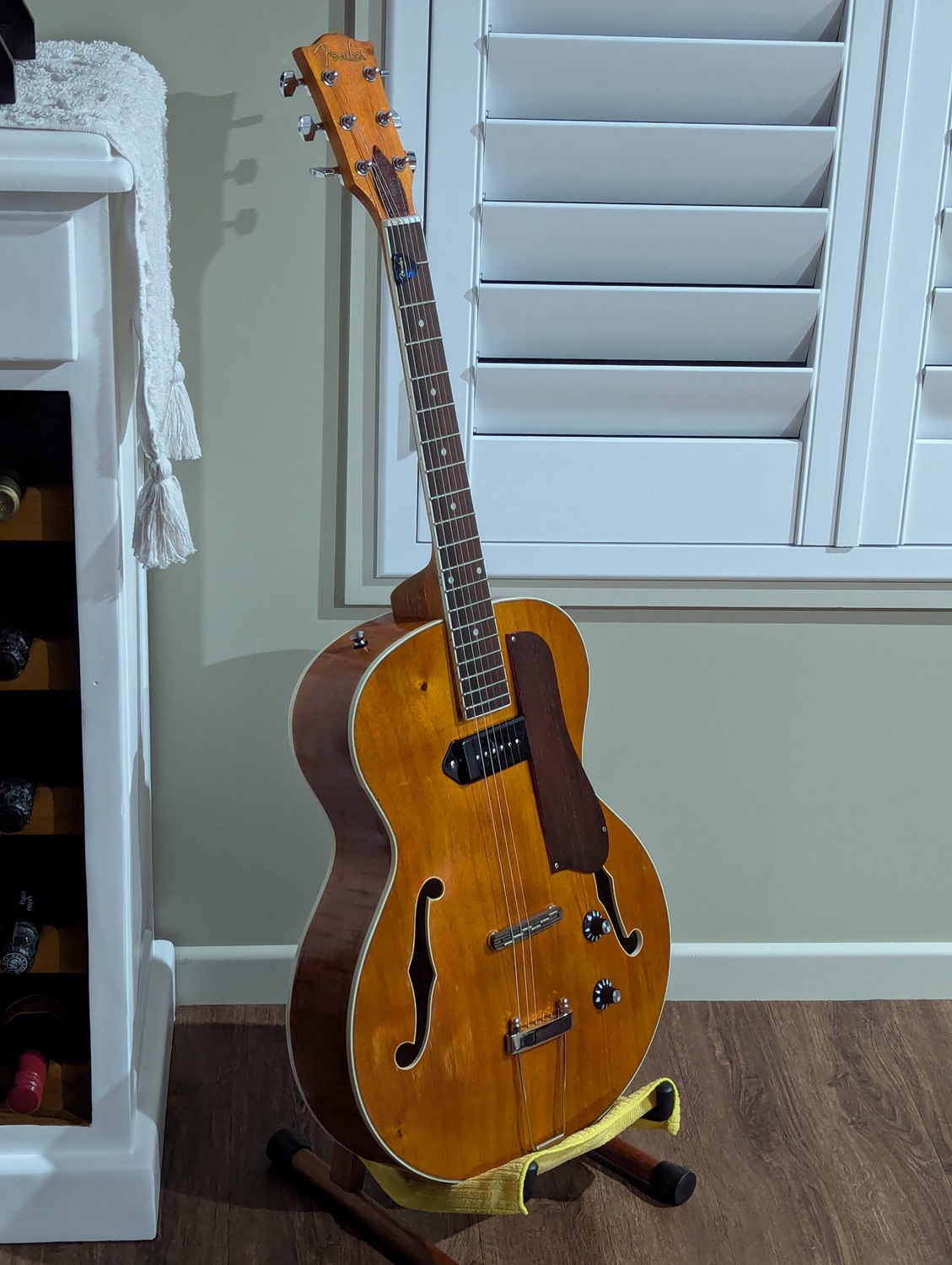

    Es-5V, tru oil hand rubbed finish, face of headstock wipe on poly, rosewood headstock veneer front, flamed maple veneer back. Kluson tuners, Epi truss rod cover, bone nut, Allparts tailpiece, knobs and rosewood bridge, GFS P90, 50’s style wiring harness (500k CTS pots, .22 orange drop cap, switch craft jack and cloth wiring). Have some vintage Allparts strap buttons to attach
  4. Liked by: HarmonIser, TZK321, wazkelly

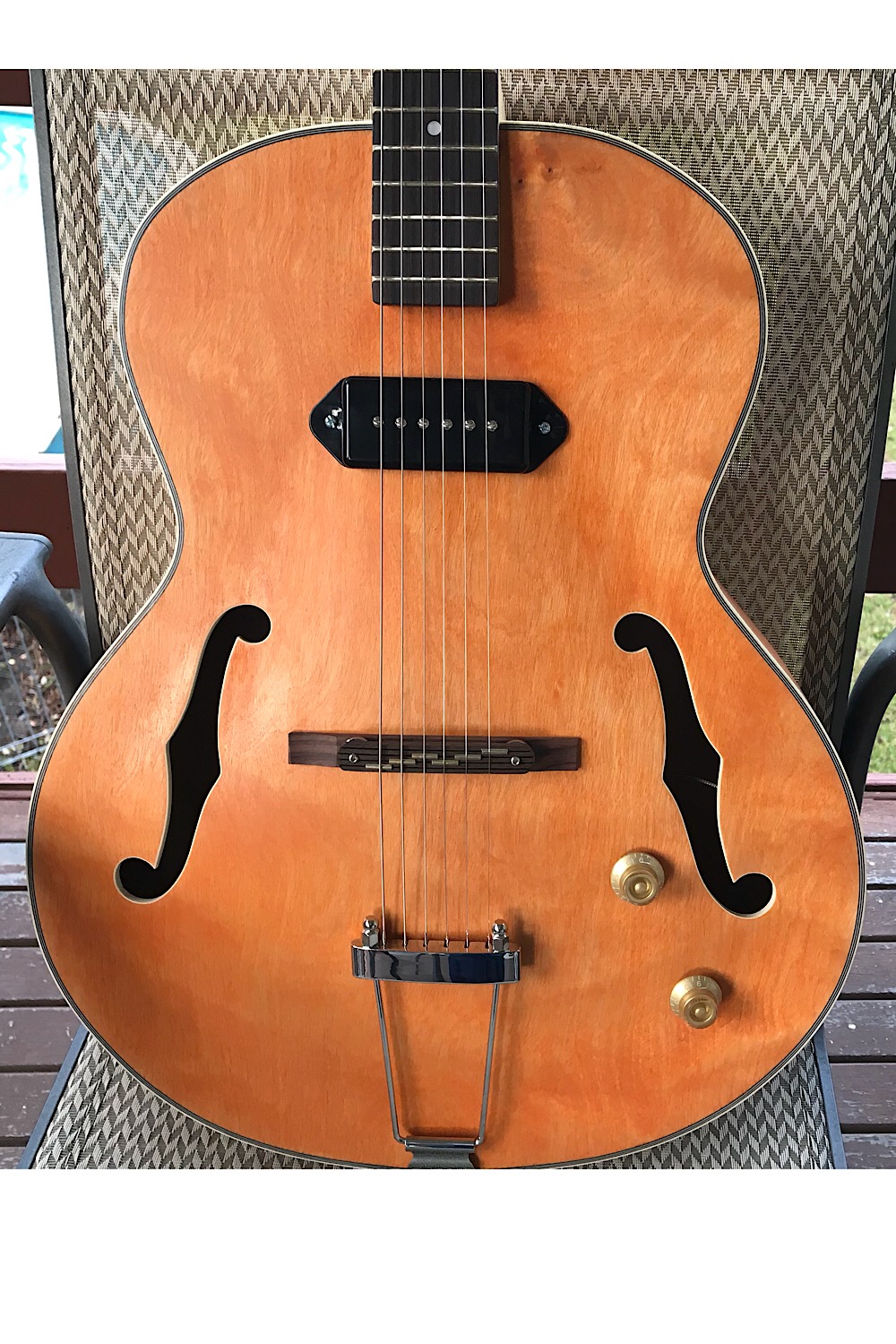

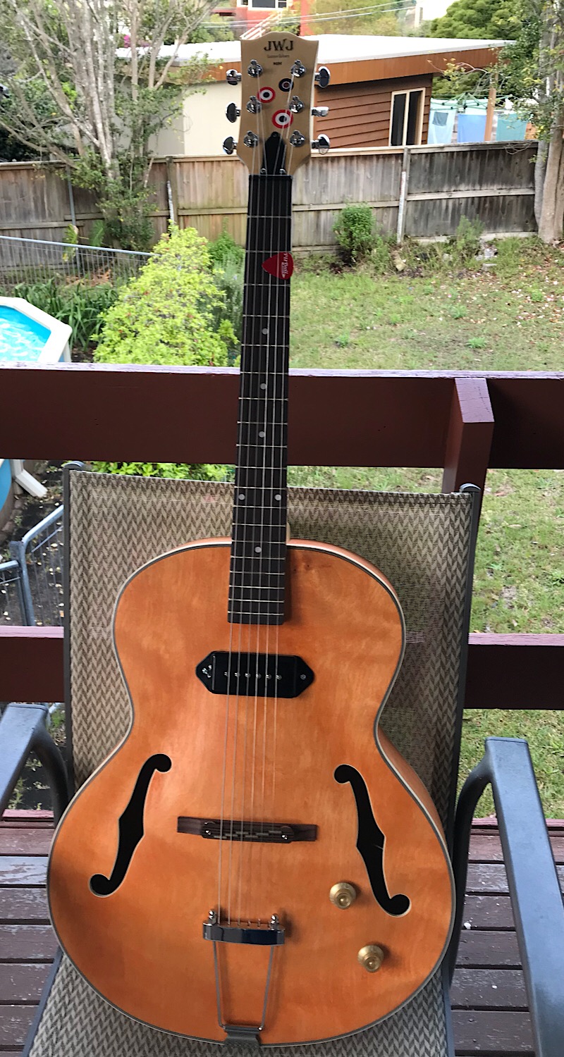

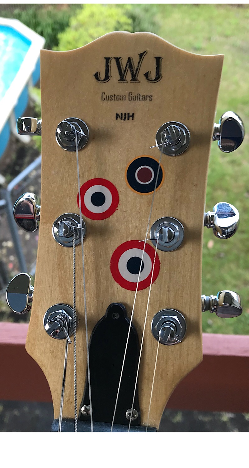

    What I’ve been working on.
    An 18th Birthday present for my son. Gave it to him this afternoon. He was truly surprised and happy.
    Standard ES-5V kit
    Gotoh Locking tuner upgrade
    Dingotone Colourless neck
    Dingotone Outback Sunset for the body
    Trussrod cover off eBay
    Headstock decals from an old 1:48 P51 Mustang model kit (off eBay)
    Would that be "Noodlers Green Marine"? LOVE IT!

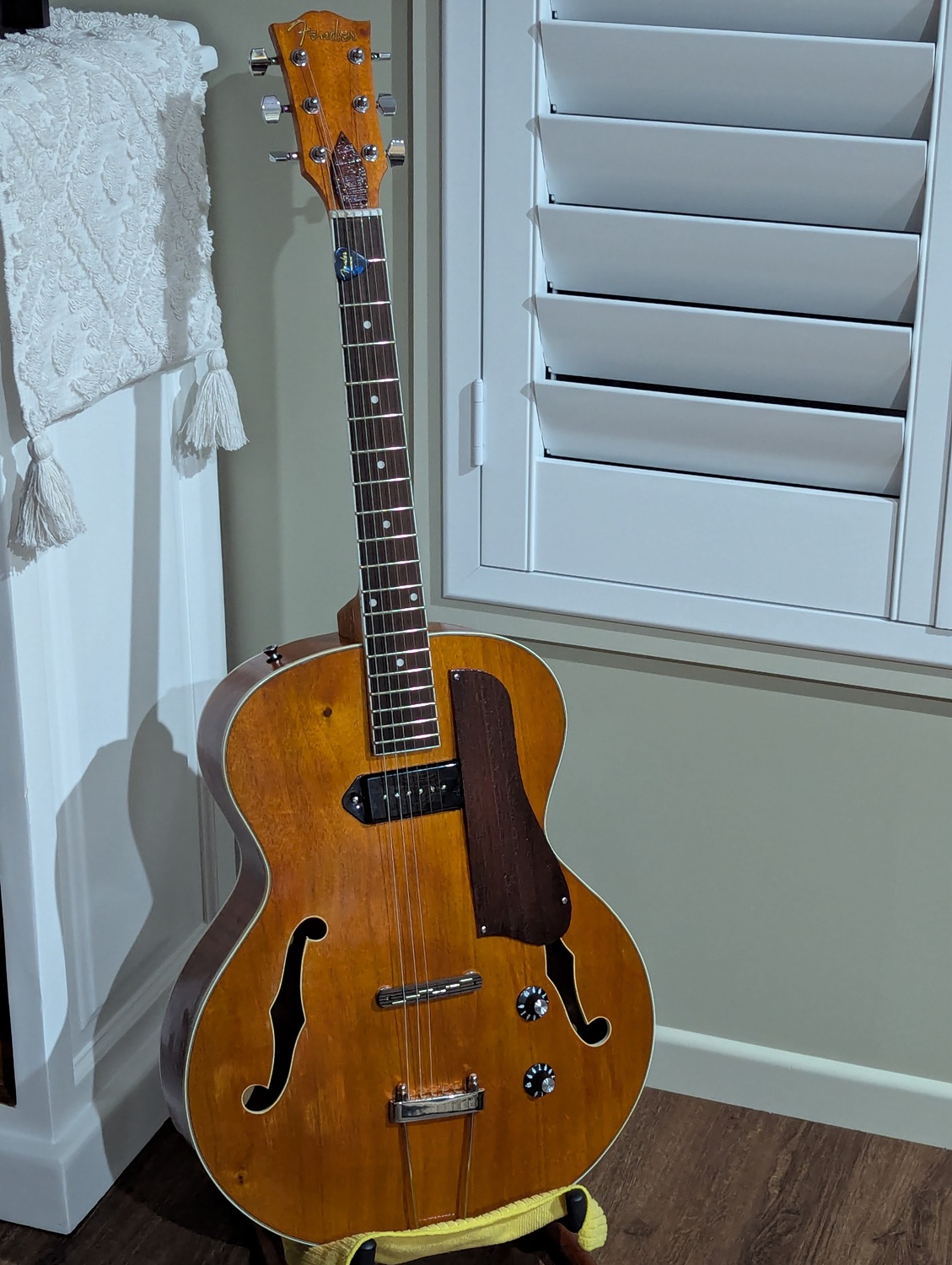

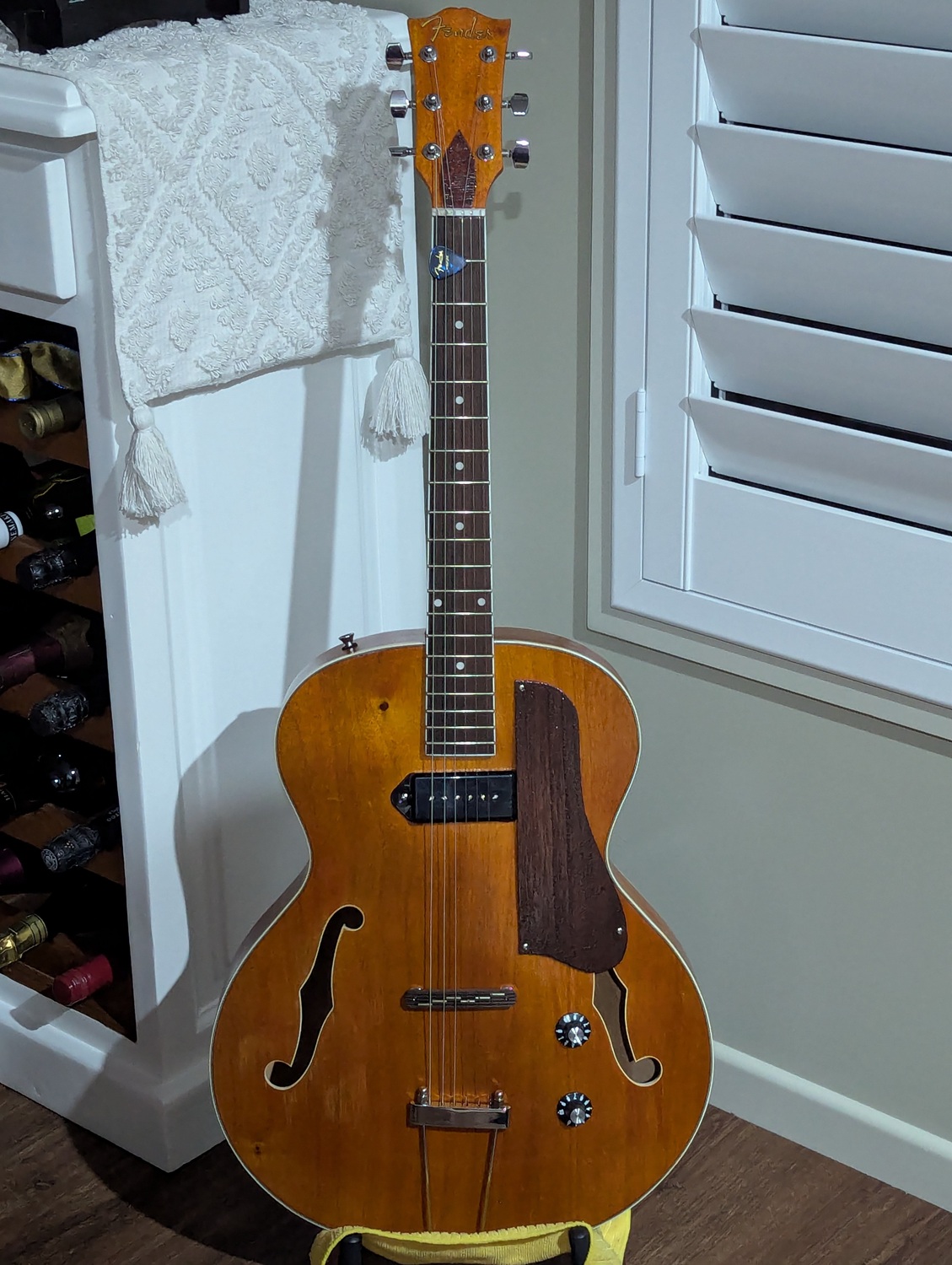

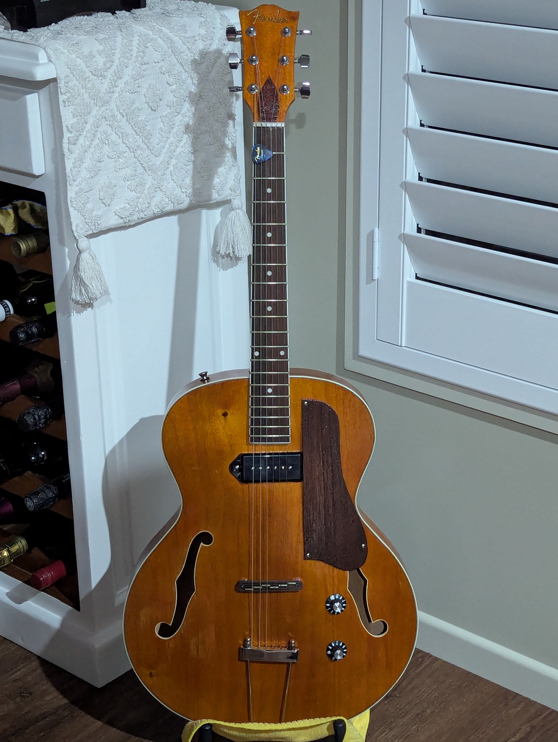

    Well, I put together my ES-5V Pitbull Kit. (Factory Second)
    Here are the final results:
    Green fountain pen ink....
    From your results (fantastic) and mine - I wish I'd seen your post first!
    I used Rit green dye (kelly and dark greens) and ended up with an "olive green" on Spanish Cedar. Not terrible (if I pretend that's what I wanted) but your results are excellent.
    Is it a greater concentration of the green ink around the edges of the guitar and less in the middle so as to give the "burst" (or did you use black ink as well)?
    Any particular brand/colour of green ink?
