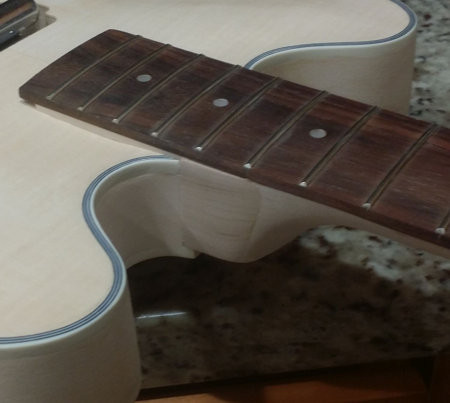

    One of the consequences of the neck on this beastie being slightly off center is that the joint is really good on one side, but not too good on the other. Here's what the bad side looked like:
    What I finally decided to do was to see if I could cover the space with a little piece of maple. The maple I have is a bit darker than what the neck is made of, but I thought it might not stand out if I matched the grain and covered a relatively large part of the side. So, I cut a very thin piece with a coping saw.
    And then clamped it into place with some yellow glue:
    When I took off the clamps it looked like this:
    Continued next post...
  7. #57
    2,923
    After about an hour or two of sanding with 100 and then 150 grit it looked like this:
    You can certainly see the edge of the of the laminated piece, but I sanded until I could not feel the edge. Will still need a bit of wood filler, but aside from that, I think this is about as good as it's going to get ;-)
