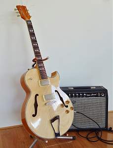

    Just a tease shot I couldn't resist posting. 1st neck check since doing the finish.
    More words and photos on the weekend.

    Hi Enikoy welcome to the forum, that ES-3 looks very cool. Please tell us more about the stains/colours

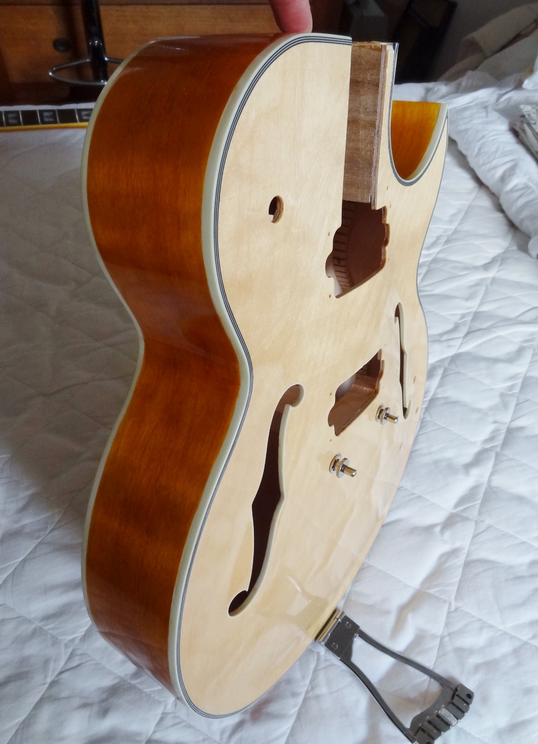

    - After some research decided to use a sanding sealer to fill the grain, easy first sand and provide a more stable base for the stain to be applied to.
    - Applied the stain, turned out perfect in the sides, the rear was good but some light cuts to grain across the body still showed up. Glad I used the sealer first, but based on the this I decided to not stain the front and leave it natural.

    - Applied coats 1 & 2 of the top coat. Probably controversial, but I used a Cabbots Poly-urethane rattle can. Very happy with the result.

    Weekend 4
    - Lightly sanded back the top coat to smooth things out. A few dust flecks and some grain was still sucking up the lacquer more than the rest.
    - Unfortunately I hit the stain in one raised up spot, affecting the darkness of the tint. Re-applied the stain carefully and mostly rescued it. Only I’m going to spot this
    - Applied coats 3 & 4 of the top coat. So glossy, I’m still thinking that satin might have been better.
    - After a few days drying the coat appears mainly flat with only a few grain dips/pocks. After much consideration I decided to go with as is. I can live with it, other people think it’s awesome, plus I don’t want to stuff up what’s there currently or weigh the timber down with more coats.

    looking great, I like the natural top
