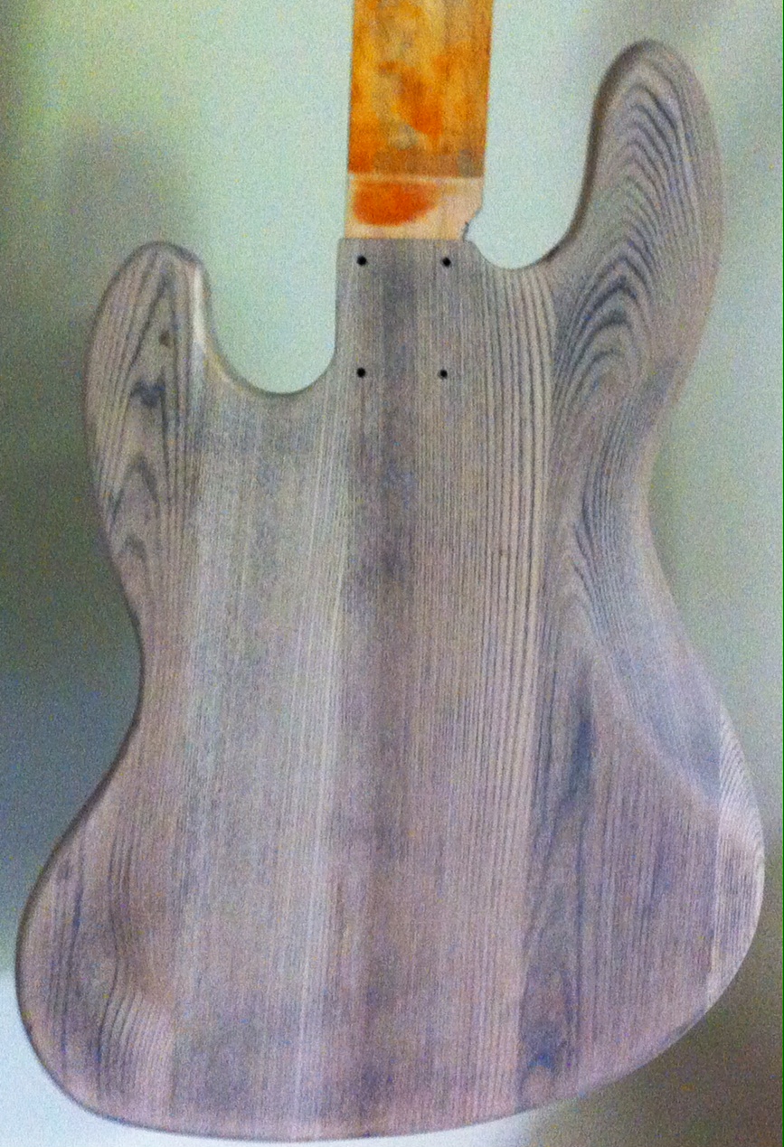

    Got stuck into the sanding last weekend and also doing a bit more work on this build after work each night this week. Here are some of the progress shots.

    Applied ebony timber mate last night. Man is that stuff messy and also has a weird stink!

  8. #18
    Sanded the crap out of it this morning to reveal some popped grain.

    Also shaped the headstock and added some colour to the body before lunch. Going natural on the neck as it has a maple fret board and TO'd it all over. Going out soon and you will have to wait a little bit longer to find out what colour was applied. With all the TO I am using on these 2 builds Woks may need to order another keg for the lengthy sentence I am about to receive in the naughty warehouse.

    You have been real busy Waz, that grain look sweet.
