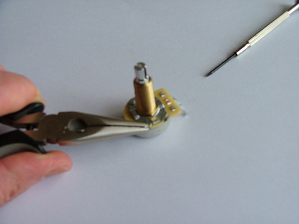

Heres how i do it.
Pull the tabs back on the pot
