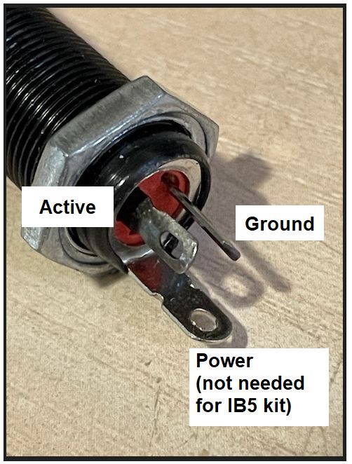

    The active and ground terminals for the PBG Stereo Jack Socket used in the IB-5 kit have created some confusion in the past so I thought I would post a thread.
    The shortest terminal is the active terminal. The middle length terminal is the ground terminal. The longest terminal is the Power terminal (which is not used in the IB-5 kit).
