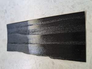

Quote Originally Posted by Jetblack View Post
Name:	Indian ink over ash 1.jpg
ID:	44620Indian ink over ash sample, this is what im looking for, one half has had 3 coats exterior grade clear coat no sanding at this point, but that's the color i'm after. I will now empty the ebonizing mix (glad it was a cheap process) good results if you want a tobacco burst color, but this puppy will be as indicated "Jet Black".............
That looks really good. I am following your experiments with great interest! Not the least reason is that I have another paulownia body that I am thinking about using to replace a heavy body in my Frankenjazz bass. The current body is black, and I'd like to keep it that way...and ebonizing with a product that won't kill me is intriguing.
