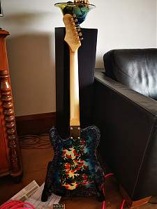

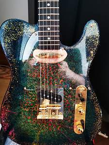

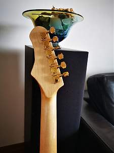

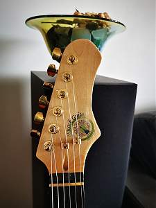

Entry from Scott Hardwick
"This is the kit that I built for my daughter Aabha who is from India. It is a cloth top. The peacock cloth represents India while the New Zealand native bird represents New Zealand. It is finished in gold hardware because only gold is acceptable for an Indian girl. The cloth was toped with 3-4 layers of a clear two part epoxy then finished with 2k automotive top coat. I also designed a decal “peacock guitars” and gave it a model and serial number of Aabhacaster 1. I upgraded the nut to brass and the pickups are vintage telecaster. All up a nice project. Still needs some better finishing round the neck pickup but still happy
Aabha really loves it and I hope the forum members do to
