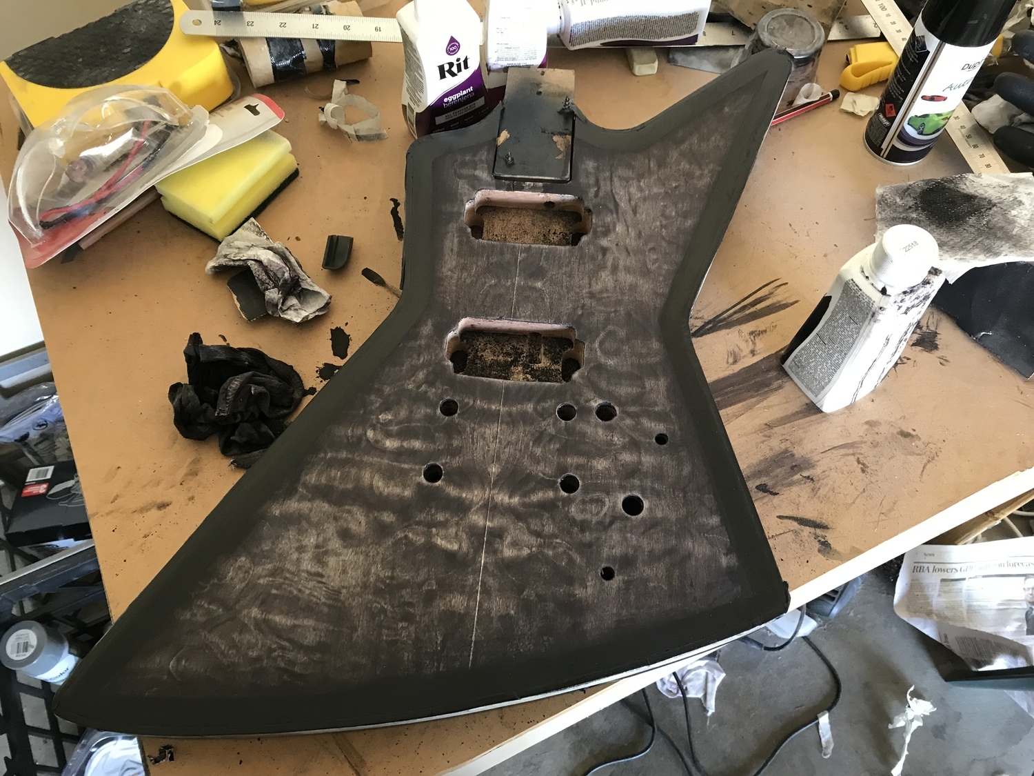

After a busy week, got to staining the veneer top with the back and sides painted. However, there were so many glue spots around the edges of the veneer near the binding that the stain just wouldn’t soak in and I was left with patches of wood which really looked ugly. So I decided to spray paint a contour around the edge of the veneer in solid black to avoid the issue of the glue spots, which I couldn’t remove with GOOF OFF or steel wool.
With the glue spots covered and a contour of black paint around the veneer edge, I am looking to do some sort of makeshift purple burst. I stained the top black and then sanded it back to highlight the quilt maple. Currently preparing it for the purple stain.
