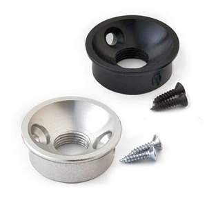

Okay, so what is an Electrosocket jack mount?, it's a piece of metal that fits in the hole in the body of a Telecaster where the output jack fits, traditionally, the output jack of a Telecaster is held in place with a thin piece of metal with a hole in the middle of it, a chrome metal cup is used to cover the output jack hole, this works pretty well when first installed but over time the thin piece of metal works lose, the Electrosocket is a replacement jack mounting system that holds the output jack firmly in place, here's what they look like:

They are my weapon of choice for all side mounted solid body jack sockets and not just on Tele's.
