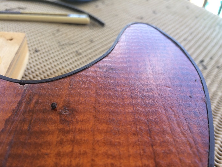

Well the binding didn’t go quite as well as I had hoped, but I think it will be OK.
A combination of problems including, bad chisel work on my behalf and using too much glue because I did not want to use any tape (even that low-tack painters stuff) for fear of damaging the surface. So I ended up with some small but noticeable gaps and some glue squeeze out on the top.
In this shot you can see some glue squeeze out on either side of the blade and just make out some of the smaller gaps
Another shot showing some more glue spots. I haven’t scraped back the binding yet so it’s a bit proud and it’s hard to make out what is shadow and what are gaps, but they are there.
And one last shot of the guitar with the binding on. I am yet to decide what colour to stain the back and the sides, but it will be a light, probably Teak as I have some of that stain laying around.
I am going to try filling the gaps with some dark Timbermate and see how it looks. As a last resort I can melt down some of the binding and fill the gaps with that, but I think that’s a bit drastic and could end up a disaster. I’ll see how the Timbermate goes first.
