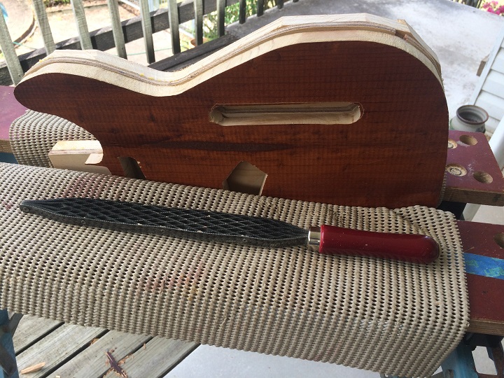

Time for a quick update.
I have glued the body together and started final shaping.
The 3 pieces ready to be glued.

Beneath this forest of clamps is hidden the body.

Next day, getting ready to start final shaping. As I get older I’m finding the power-supply for my Shinto rasp needs more rests and regular recharging.

Before, close up of how rough my initial cuts are.

After being attacked by the Shinto.

Next will be final shaping, dummy assembly to position the bridge and adjusting routing for pickups. Then some work on the neck and frets.
Stay tuned.
