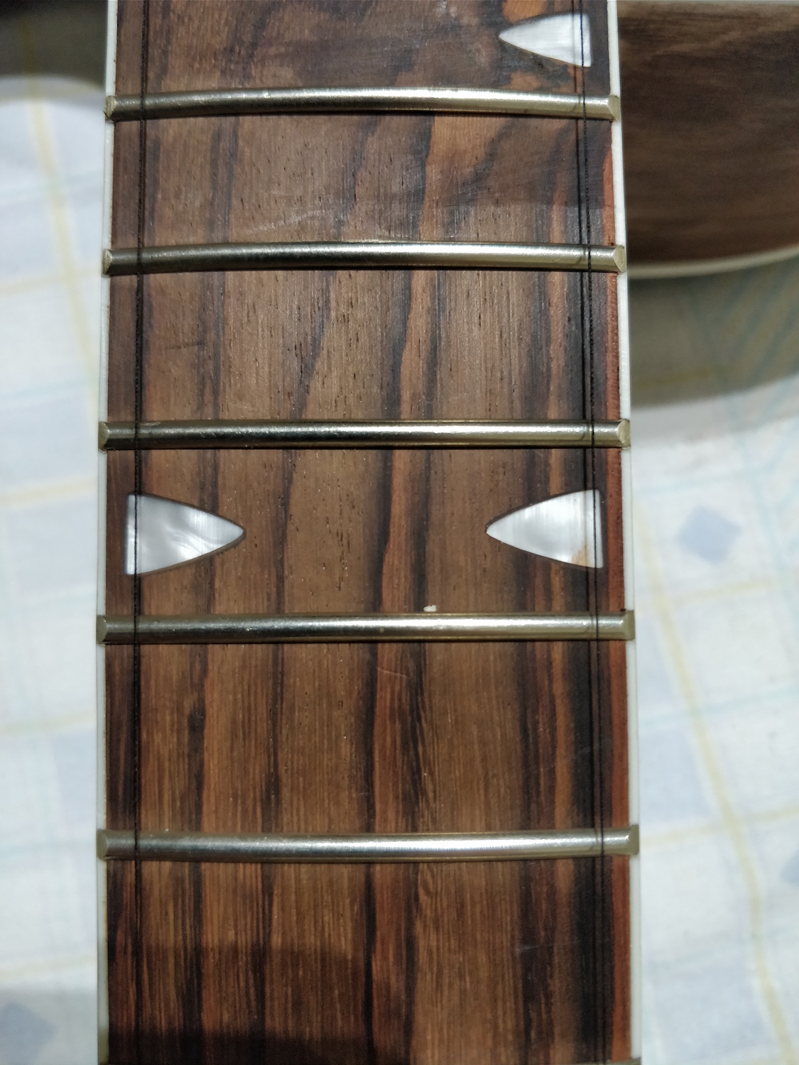

The next step will be to glue the neck to the body. But when I insert the neck on the guitar body and push it firmly, it leaves some gaps as I showed previously in this diary. I was thinking that I didn't need to do any major adjustments to it, but after the measurements, I became a little worried.
The alignment with the nut is straight but I don't think the angle is correct.
Let me show you.
Here's a picture of the alignment. I attached two strings (not guitar strings but I stretched them to get some tension and see if the alignment was correct).
