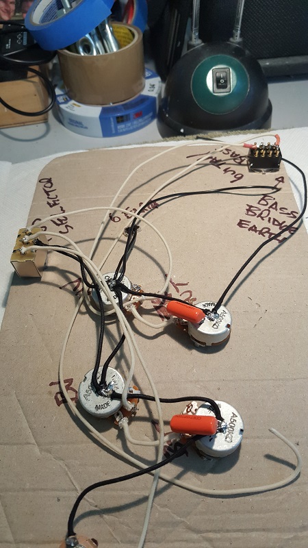

    I thought about options last night, and one idea caught my attention. How do I get solder to go where I want it and to stay there? Much reading later I came up with this.
    From Jaycar...it is no clean up....nice for control cavities....and I blobbed it on lightly with a toothpick....it worked a charm. Now to wait until the body and necks are ready......again again again. phhhew.
    The job is not as neat as some I have done....but minimal heat to the connectors on the switch....no slop of solder....heat shrink covers it up a bit though.
    I used a cut off lead (the long legs) from a capacitor, and I bent the lead at a short right angle and soldered one each side in the middle connector.....then pointed the open end at the outside connector on each side. I then took my template to the body and worked out which ay the wires would need to enter and leave the socket in the body.....then soldered the end of the leads to the incoming wire and the connector all in one rosin flux dribble.....I hope it works and stays connected for me. Multi-meter...as recommended above...shows connectivity in the right positions.
    Oooh this is the fun bit now.
    https://www.jaycar.com.au/solder-flu...g-tub/p/NS3070
    P.S. Yes wires all over.....but the majority of the harness will need to be made inside the body.....I have probed the holes in the body....man it is going to be tight in some of them.
    I am wondering about joining wires in locations together and only sending one wire down the drilled holes. E.G. join the earths for the Bass pickups and only send one wire down the tube. Same for the Guitar pickups. A query to those that know. Will I have to isolate the earths for each guitar from the other? e.g. All the Bass earths within a Bass circuit that ends at the Earth under the bridge. Or can I make shorter runs to back of pots or a joining wire and only run the minimum of one wire to a common earth point somewhere with space to solder 14 million earth wires?
    The big switch is going to be the one that hogs the hole.....four sets of wires in and out.....may have to use the thin plastic coated wires....I don't think the pickup wires will reach anyway....so will have to extend them.
