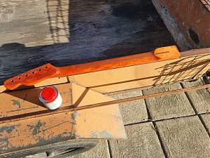

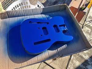

    I have mainly been focused on the headstock to get my head around some of the techniques needed before tackling the body but have also started on it.

    Received the Kit yesterday and proceeded with sanding and fitting the different neck, making sure to adjust the neck alignment before I started painting.

    After sealing the body I started work on the neck to stain the wood, unfortunately I believe my stain was off as the end result is not what I expected.

    Good luck with your build. + The blue looks great!
    What stain did you use?

    Feast Watson Maple Prooftint Stain, the stock photos show it more as a yellow tint but this has come out more orange.

    Sanding the neck with too fine a grit can cause uneven take-up of the stain. If you’ve gone finer than P240, I’d sand it again with P180 and try staining again. You’ll put the very smooth finish on the clear coat.
    But the neck may also have been treated with sonething like shellac or a sanding sealer before you bought it, in which case that will need to be sanded off before the stain will take.

    Thanks for the input, I can't get specification of the neck itself other than intended scale length and measurements but during mock up I checked the position and a quick measure had it almost at intended length.
    I gave the neck a sand down of P180 before starting any work on it, the stain was darker on the rag than what was expected, in hindsight I should have test first.
    The Feast Watson website shows the stain pretty much that colour. Though the Bunnings website shows it much more yellow on ash. That could be wrong or they could have used a very diluted stain . All those Prooftint stains seem pretty dark to me, so were probably applied undiluted in the FW examples.
    You may need to dilute the stain considerably with IPA (isopropyl alcohol) or metho (the official FW ‘colour reducer’ will undoubtedly be some alcohol based thinner). And always test on a piece of scrap wood first, say pine, that’s a similar colour to maple.
