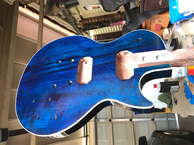

    As for the mock neck (or lollypop stick!) you can screw it into the top shoulder of the body - I did that with my set neck SSCM-1 build which was a set neck. Others put some dowel into the jack plug hole!.
