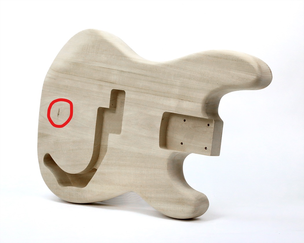

    Hi. Am new at this. Any instruction on getting the grounding wire from the pot to the bridge? It seems it needs a hole drilled from the pots to where the bridge sits, but that doesn't seem right. Much thanks. Corbs
    There is normally a pre-drilled hole for this purpose. Highlighted here in red.

    Much thanks Simon. That's sounds good. There's no hole so I'll go by your advice. Can I ask do I solder the wire or just let the bridge sit on it? Cheers, Corbs
    Make a fair length of bare wire and just sit the bridge on it. If you use a fairly thin bit of wire for the ground wire here, you can probably knot it first, so that the knot sits in the vertical hole you drilled first, which then stops the wire from being pulled too far into the cavity. Just have the exposed wire sitting on the body and you can spread the strands out so that it doesn't add any real thickness.
    Brilliant thanks again. Corbs
