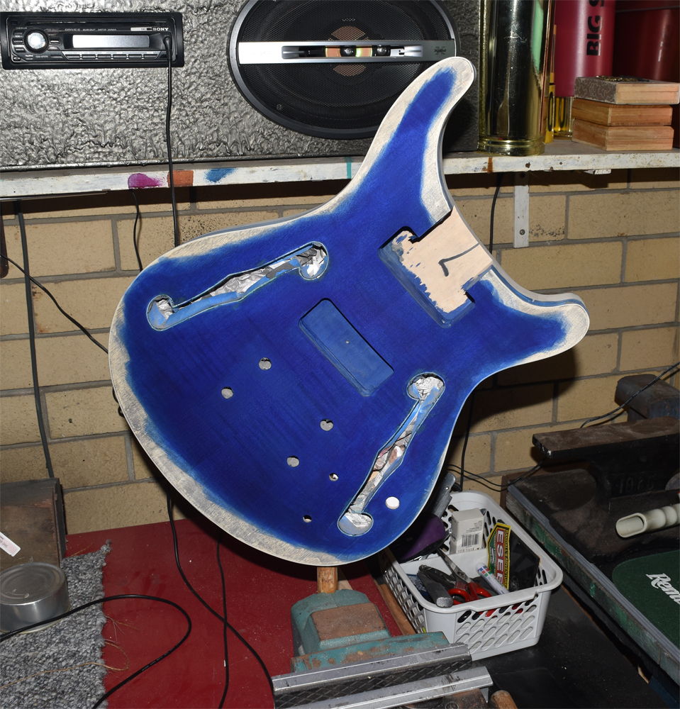

    Finally kicked myself in the bum and got into this. Have done a black timbermate fill and sand and blue ink stain. I've tried a silicone liquid mask again on the binding, see how it goes. Will do the black burst next, then the frets, then glue the neck in.

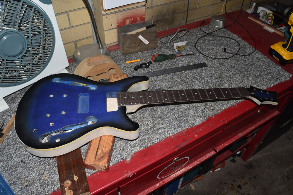

    Burst done, frets done, neck attached. Body staining tomorrow

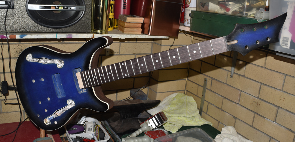

    tidy up, then clear coats to come.
