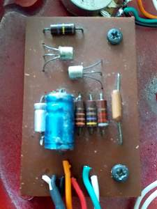

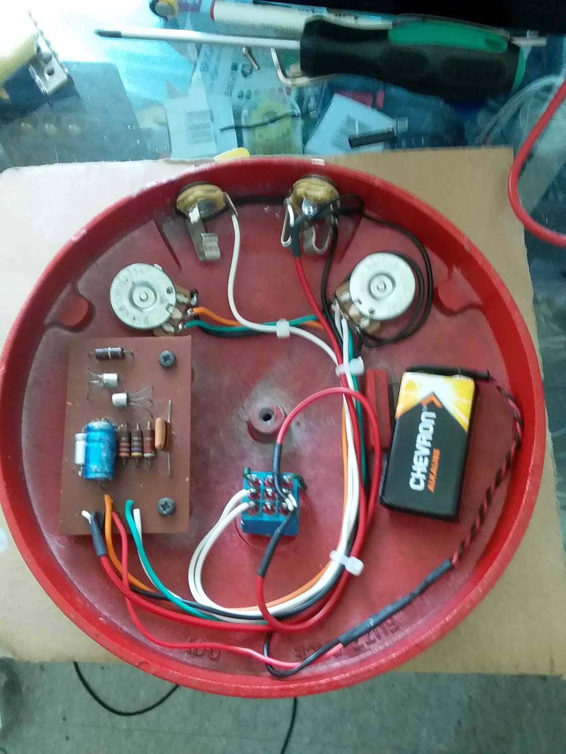

    Hey Everyone,
    Recently, my red Jim Dunlop JD-F2 Fuzz Face died and stopped working while I was in the process of doing some re-organizing of my pedal board so I could add my Boss MT-2 Metalzone pedal, well, my red Fuzz Face pedal actually didn't just suddenly stop working, it started oscillating and then stopped working, so seeing as I had been looking for a good excuse to convert it over to silicon BC108C transistors from the stock NTE 158 Germanium ones, I decided to go ahead and remove the stock circuit board and replace it with one that happened to have two BC108C silicon transistors soldered onto it.
    It's a well-known fact that Germanium transistors are temperature-sensitive, and, while the stock JD-F2 circuit board does incorporate a board-mounted thermistor as a way of mitigating any temperature effects, I decided to just cut-to-the-chase and do the conversion to silicon transistors since they are far-less temperature sensitive.
    The replacement Fuzz Face circuit board I used was one that came as part of a kit of parts I had ordered from a company in England, called Pigeon FX....if my memory serves me right.
    I'll post a pic of the insides of my red Jim Dunlop JD-F2 Fuzz Face, which I took after the conversion had been done, and I'll also post a link to a demo I uploaded to my soundcloud account, so you can hear what it sounds like.
    Here we go:
    Insides of the red JD-F2 Fuzz Face after the conversion to BC108C silicon transistors.

    And a close-up pic of the replacement circuit board.
Name:	Red Fuzz Face 2_resized.jpg
    The two silver things with three legs are the two BC108C silicon transistors.

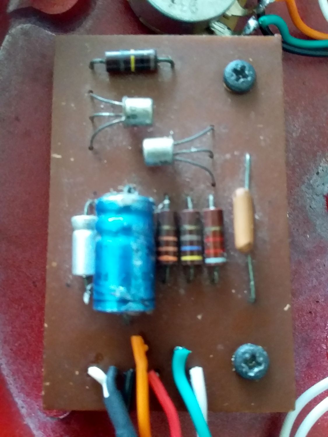

    So today I decided to order some new caps for my red Fuzz Face pedal from Evatco, one leg of the original 10nF output cap literally fell off it as I was doing some troubleshooting of the pedal to figure out why it sounded real blatty when first switched-on, after a while the sound would gradually become more like what it was supposed to sound like, I thought that maybe one of the solder joints might be dry and need re-doing, so I went through all of the solder joints and re-worked them, when I got to the solder joints for the 10nF output cap, I used some solder wick to remove the old solder so I could put new solder on, and as I was in the process of removing the 10nF cap one of the solder legs literally fell off, I didn't have any spare 10nF caps so I used a 47nF/630V greencap as a temporary replacement to get the pedal going again, that got rid of the initial blatty-ness.
    I ordered the following caps from Evatco:
    X1 .01uF/630V Metalized RT.
    X1 2.2uF/100V Electrolytic RT.
    X1 20uF/50V Electrolytic RT.
    I went with express postage so the new caps should arrive by maybe next week at the latest.
    If you look at the close-up pic of the circuit board in my previous post, the output cap is the one closest to the two mounting screws for the circuit board.

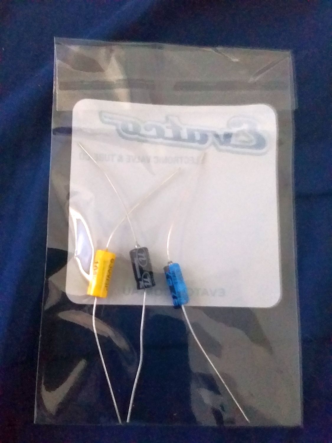

    Woohoo!!!!......the new caps for the Fuzz Face just turned up in the post today, so I'll be installing them on the circuit board tomorrow.

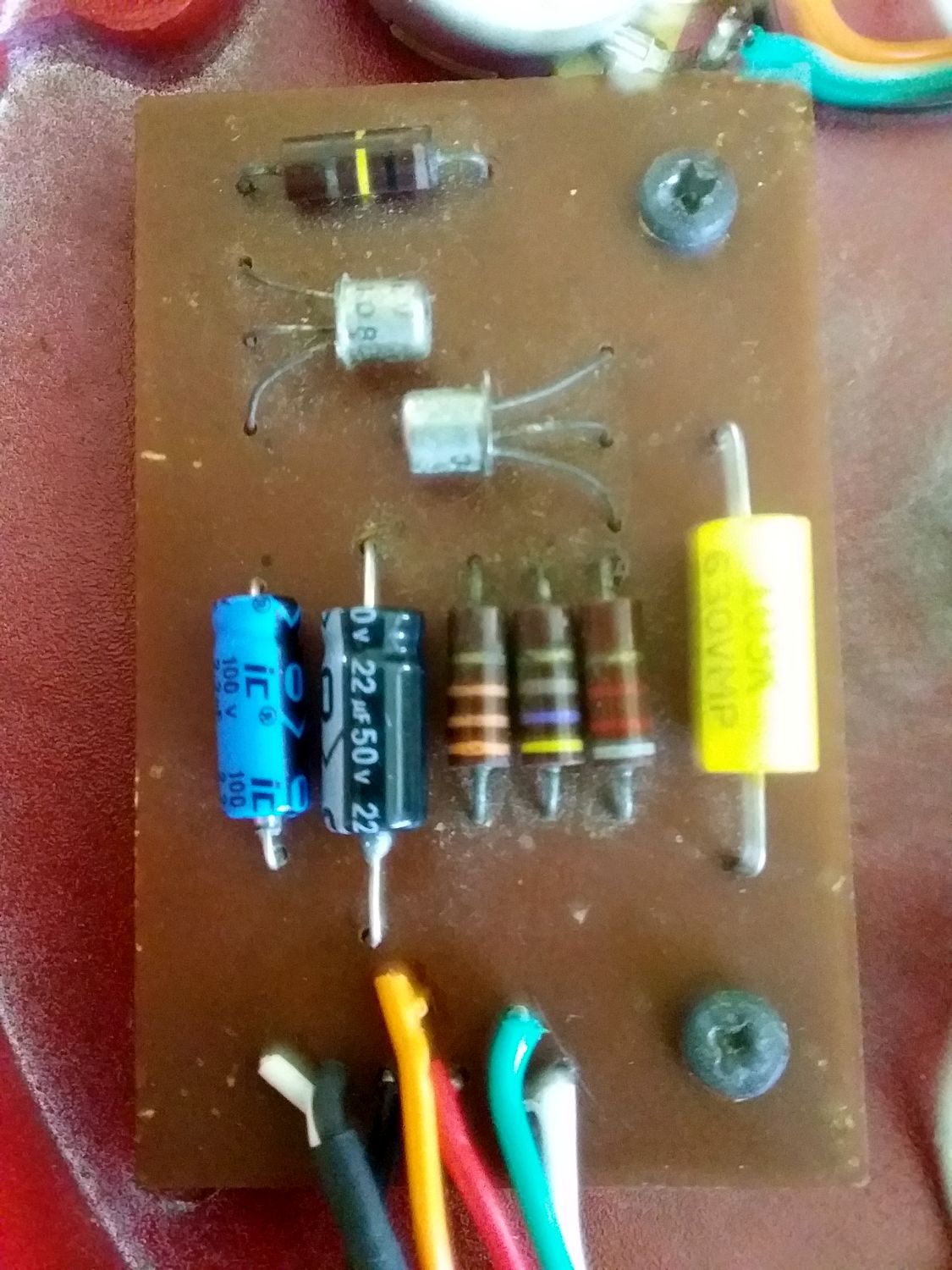

    New caps installed on the replacement circuit board:
Name:	New Caps Installed_resized.jpg
    Gave it a test out and it's all working as it's supposed to, so I'm calling it job done.
