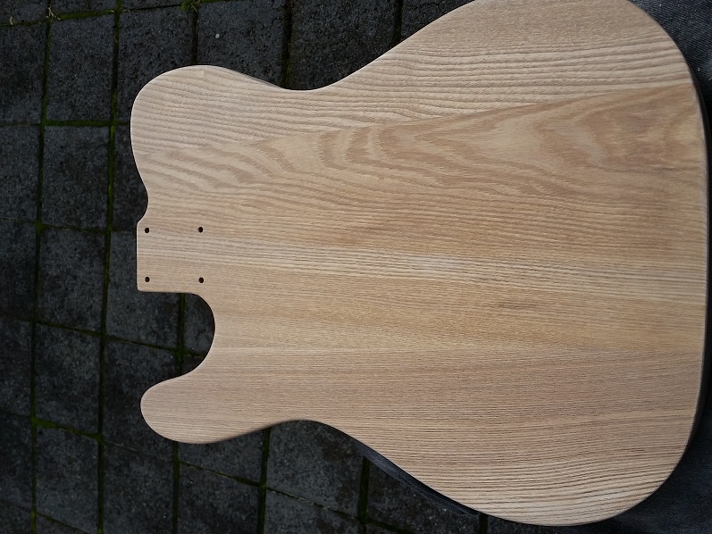

    here is a couple of work in progress shots for anyone interested.
    Just finished sanding with the 180 grit. Prior i had sanded back with the 120 grit and applied a coat of Sanding Seal.
    The last shot is a new coat of the sanding seal on the front side and sides.
    The shot of the side of the body is where i am a little unsure of which direction i should be sanding in.. currently i am sanding with the flow of the dark grains.. but as the topside is running the other direction, should i following that direction instead. :/ ?

    It can be a bit of a trick, but with ash you should be able to feel the coarse direction with your fingers
