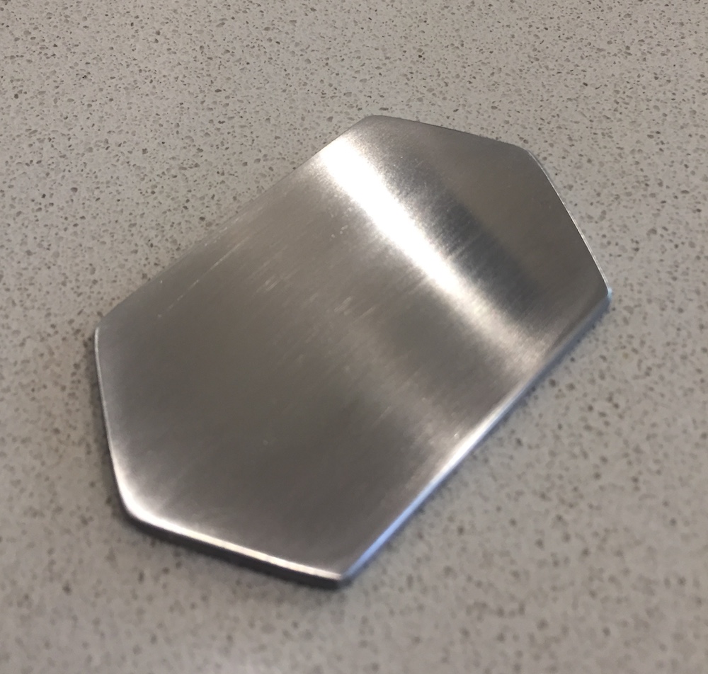

    Because I'm an impatient sod I just knocked this up from a piece of 2mm thick aluminium I had in the workshop. This is just with 600/800/1200 wet and dry sanding and a quick polish. There's potential here me thinks as I did this pretty quickly. A bit more time on the sanding and polishing, and then sealing as you suggest Dave and it could look okay. Now cutting the slot for a 5-way switch? THAT could be interesting!!

    Sorry, that's 3mm aluminium. The only frustrating thing is the largest size I can get from the Green Shed is 50mm wide. Fine for a switch or telecaster control plate, but you'd need closer to 70mm for the plates used on a Jaguar (which is what I'm essentially looking at). I guess there must be more specific suppliers where I could get larger dimensions, but hopefully without needing to order metres of the stuff.

    standard aluminium sheet is 1200mm x 3600mm (4' x 12') so the 1/3 of a sheet that Dave mentioned is still 1200 x 1200
    looks good Chuck. So will you incorporate the switch plate with the new pickguard ?
    That's the plan - I guess it's more like a Jaguar setup than the Jazzmaster. Ideally I'd make plates for the vol/tone controls, the lower bout 5-way switch (above) and another for a toggle on the upper bout. All three plates would ideally look like the ones on a Jag. As I said before, my only concern is how these aluminium plates would look with the regular chrome of the bridge/trem and even the chrome pickups.
